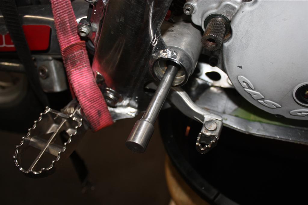

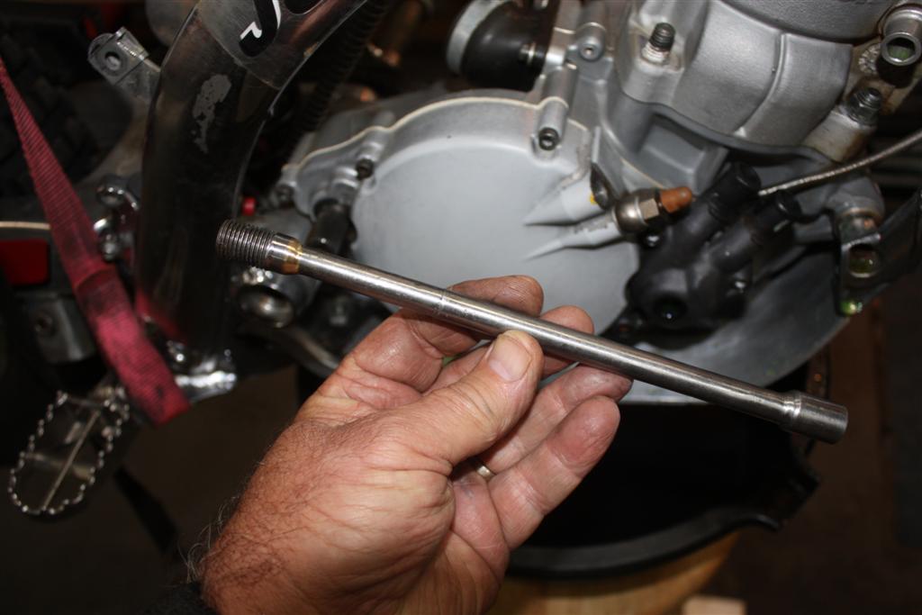

Al,
I'd try some penetrating oil to see if that helps. You need to be fairly gentle as that spindle is aluminum.
Sometimes loosening the engine mounting bolts and/or sump guard bolts will "relax" the hold the engine case has on the spindle (the engine is a "stressed member" part of the frame). It will also make it easier to line up the spindle end when you re-install it. There is a special tool that threads into the spindle and makes it a snap to align the spindle end into the frame hole but you probably can do it without the tool. I made a couple of these tools and they really help if you are doing this job now and then.
Jon
I made two heavy-duty shop spindle tools but also this little short one I carry in the toolbox in the bike trailer. You can screw it in the end of the spindle and tap the spindle out. It also works as a leverage tool to draw the spindle end into the frame hole upon re-assembly.
Jon
