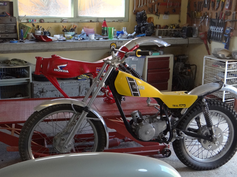

September 30, 201412 yr Greetings from Mexico. Below is a picture of my Sammy Miller seat/tank unit on my TY. I am in the final stages of refreshing this bike and my TLR. This unit is at least 15 or 16 years old. It is absolutely top quality stuff. In my case it has never been subjected to any ethanol although the occasional beer may have been spilled on it. The difference is that it has lived most of its life in Mexico. Here all of the corn is converted into tortillas, and all of the petroleum comes out of the ground...courtesy of dead dinosaurs. It sounds like your problems have been solved courtesy of SMP. Cheers. This was just a chance for me to show off my TY. More and better pictures at my blog http://meditarivemachinery.blogspot.mx/ Mike
