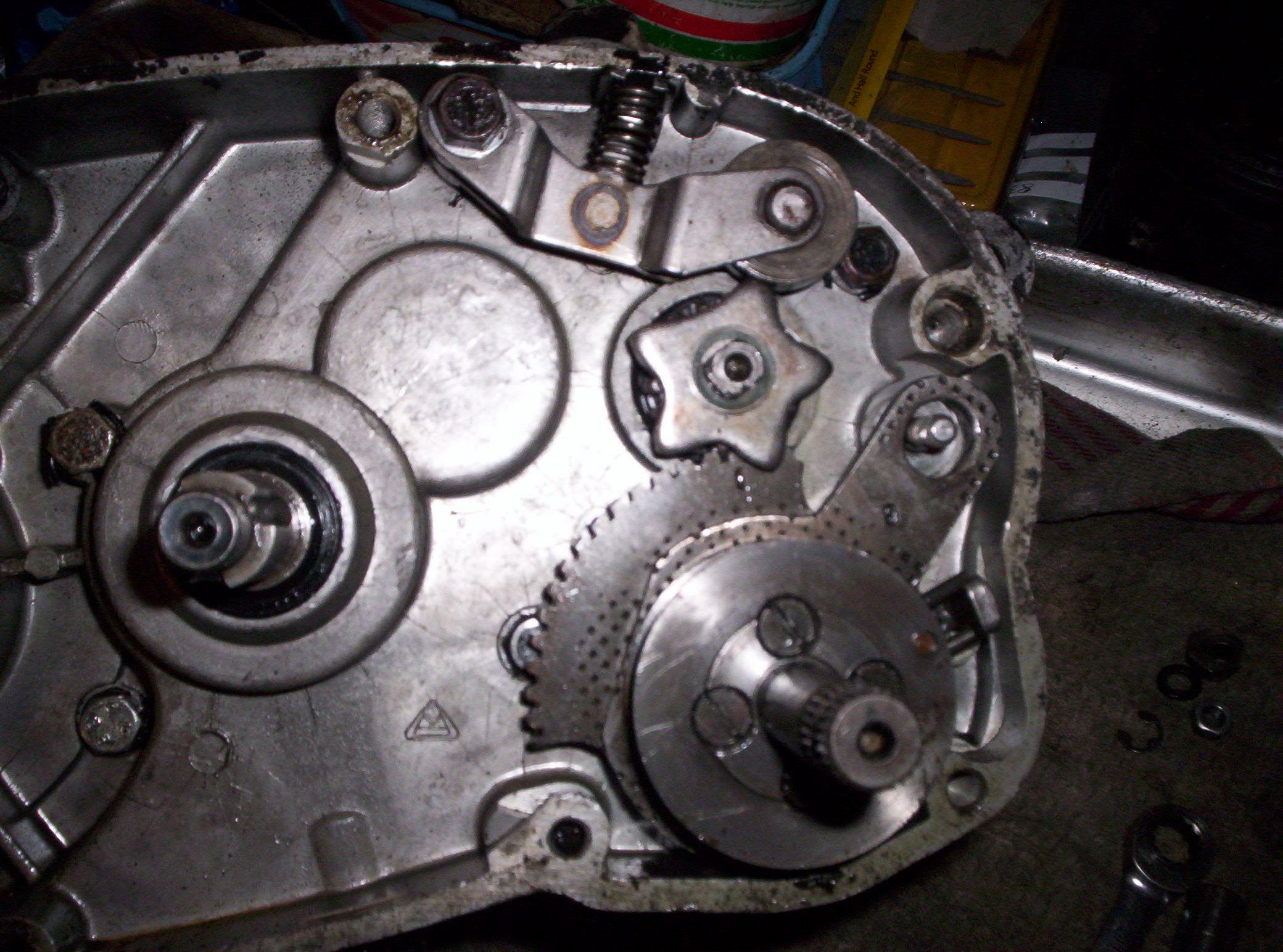

Quick update. Stu was spot on with the area of the problem. After takingh the cover off I could see the 4 bolts holding the gear change mechanisum were almost falling out. I took it apart and but it didn't really neeed cleaning. Reassembled and put some locktight on the bolts. All working again now EXCEPT I seem to be only getting first, neutal or second. Nothing higher. Not too worried about that today as I want to have a go in a local trial with a mate tomorrow so first will do for me.
I'll take it apart next week and see if I can fix that.
Thanks Stu !
Edited by diggers1050

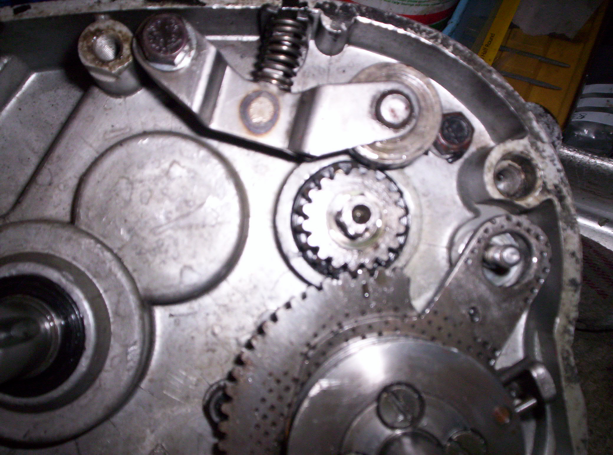

Sounds like you haven't lined up the ratchet mechanism correctly when you put it back together. There are marks on the ratchet and selector drum spline to line up with the gearbox in neutral. If they aren't the selector won't travel far enough to select the upper gears. Below are a couple of pictures to illustrate, they're from the 330 I think but the principle/arrangement is the same. The star shaped wheel that holds the selctor in it's selected position also needs to be fitted correctly.
It's only a 10 minute job - being stuck with 2nd as your highest gear will be a real pain even in a closed circuit trial.
Also further to Woodys post - there is an eccentric adjuster that can be played with to make sure you get all the gears. Its shown on Woodys picture, but the adjuster isn't fitted - its should be in the steel plate which is shown near the right side of the picture. This is held in position by a 6mm nut - back off the nut, rotate the eccentric adjuster a bit and then nip up the 6mm nut. Try for all gears, repeat until it works.

On 12/10/2011 at 11:16 AM, woody said:
Picture 2
Is the star shaped wheel in the picture in the neutral position?
