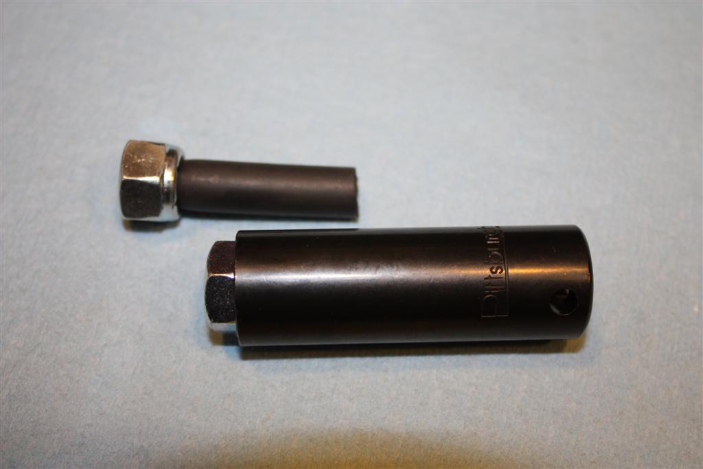

If you run into unusual Allens like this one, you can make an "emergency" Allen wrench by fitting a nut that just fits into the Allen hole with a short piece of fuel line so that it will slightly protrude from a socket. That will get you by until you get the correct one.
