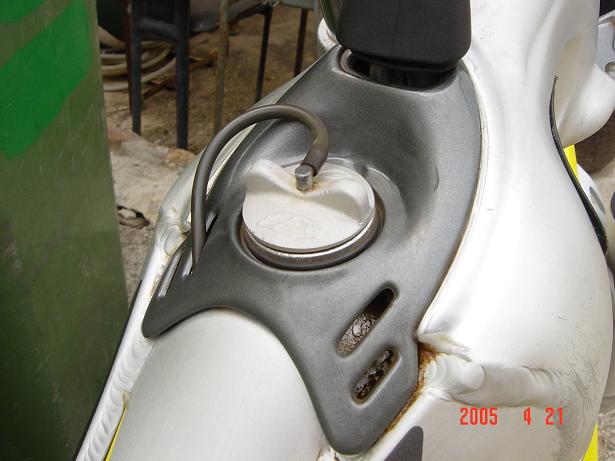

Hi all...this is probably a real dumb question...and if I tried hard enough, I'd probably work it out myself...BUT...with my luck I'd probably break it!!...so can anyone tell me, how do I remove the silver plastic bit in the picture..so I can clean underneath, and re-seat the black plastic/cable holder bit.
THanks in advance for any help :unsure:
HI STU, unscrew you filler cap and remove, then use a small pick or screw- driver and remove the rubber 'o' ring around the filler neck and then lift off the plastic cover replace in reverse :unsure:
The rubber boot never stayed in place on my 02 and 04 Beta's but it's fine on the 05 bike! Don't know why though - maybe a dab of silicone would help Stu
Thanks both...yep the rubber boot thing stayed put on my 02 Beta..but on this 03 one, its never stayed put...but now I know how to lift the plastic bit..(thanks landrover!) I can try to sort it out.

you can poke it down using a small flat screwdriver if you can't be bothered to take it off.
