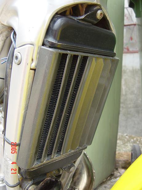

Can anyone tell me how to remove the silver plastic radiator surround..like in the picture. I guess its easy, but dont want to break it trying.

Lever off with small screwdriver etc - its just a snap on fit.

Removing it: -
Grab any of the fins as near to the corner as possible and yank it off - it has 2 or 3 small plastic lugs at the top and bottom that fit into the metal ledges of the radiator.
Replacing it: -
Stand the cover in the ledge at the bottom of the radiator and twist the top slightly so that just one corner snaps in to the top ledge. Then push/shove/whack the last corner in - bit of a snug fit so don't be shy :unsure:
Thanks both...thats allways the trouble..I'm too shy...broken so many bloody plastic bits on road bikes before now, that I dont like shoving things too hard..at least plastic things..!
ANyway...will have a go...I think you're saying the plastic lugs..are probably on the top and bottom of the shrowding right??..
