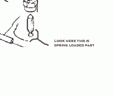

Well, Long story shortened, it was the Float's needle was coming apart. It has a pin in it, you know that is spring loaded. Anyway, the pin part that goes inside the needle (that you guys wont normally ever see) has a fat part that is crimped to catch it inside the float needle, so it can NOT come apart, well this time of looking at all of this and cleaning the needle and seat, the pin & spring popped out of the needle on me... IMHO, I was lucky as heck to find it !!
erm well sort of, I had nothing to replace it with... Lucky I was at the table at the time though & I had all the parts to that needle. But what to do? What I saw was, the factory crimp was not as good as it prolly should have been... and the pin was able to back out, while in the carb, to where it would stick half fell apart, I was now extra long and have the needle closing the seat.
For months, it might been able to "rattle" back into its place and the bike would run sort of fine, if the floats only let little bits of fuel in, like during section ride or what not. but long loop riding, where the floats had to drop lower, then it would catch, and as gas came in , it closed off the gas sooner keeping the level really low, til not any at all...
Well I had no spares day 2 was upon me, and I broke the factory crimp trying to re-cripm it closed like they did. Oh man I thougth I was done too... I had to compete in less than an hour. So luckily, I crimped the rest of that needle near this end, at least enough with my pliers(holding the spring Compressed fully) to where that spring loaded pin, no longer could move.

Thought I should update with info I have gleaned from getting my new needle and seat into the bike yesterday
and ask outloud...
Ordered the replacement needle and seat, GUESS WHAT?
I recieved it, the needle is (now) a solid unit!?!?!?! kewl but hmmmm
however it was about 1/2 - 3/4'ths of a milimeter longer lenght overall needle (only if you compare to completely compressed needle I had though... SO float 'hanger' arms, are they supposed to be prefectly level, when carb is upside down (needle is seated?) or hmmm anyone have thiers apart lately and notice?
