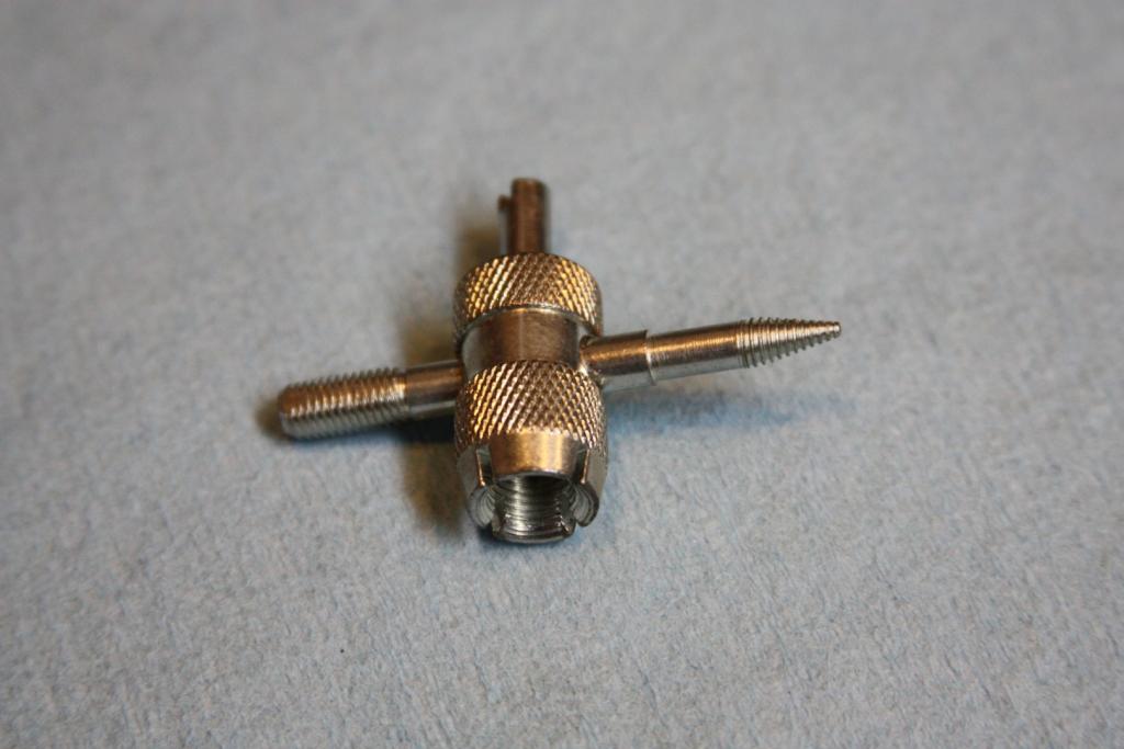

There is a common, inexpensive tool available in auto supply stores that will re-tap the threads for both the valve and the cap as well as install the valve.

Look for one of these.

i jon yes i allready have one off them. and i did run it through the threads but was still leaking air. ive replaced the dust cap last night to a plastic on insted of the rubber on and ive just check the tyre seems to be holding air finggers crossed.
