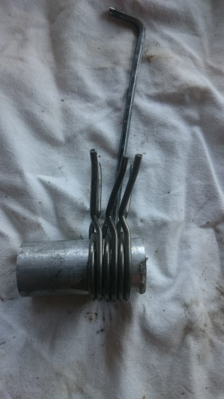

Well I've taken the casings off and drained all the fluids. But can't find my bloody 8mm socket!!! Typical! So the clutch is staying on until I can find it. However looking just below the clutch I can see the bottom part of the spring is in tact and not located properly. I haven't found any broken spring bits after having a rummage around so fingers crossed it has just come dislodged. will probably fit a new spring for good measure.
Will report back later when I have more progress
Had the exact same problem on my son's 2012 125 about three weeks ago... Shifter would stick in the up position, and only return with a tap of the lever. Disassembled expecting to find spring parts in the bottom of the case, but no broken spring. Seemed that the spring had become dislodged, but also may have become weak or slightly bent somehow, as it wouldn't seat and stay for very long when we tried to simply put it back in place. So, we did the job over a second time and replaced with a new spring - Viola, all is good again!
Save yourself the 2nd tear down, and just put a new spring in on the first go... The cost of the part is much less than the aggravation of doing the job twice!
