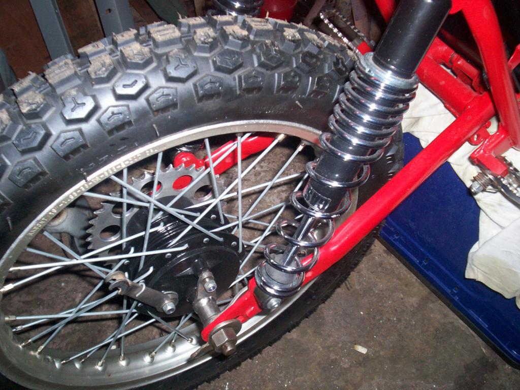

February 19, 201313 yr Got a mont 200 project which I'm on with and wondering what would be best shocks to put onas I have betor on a ty175 and I find these fine I just wanted some input on other shocks
February 19, 201313 yr See my recent thread on NJB's in the montesa forum. I'm very dissapointed. I had Betor shocks on a TY175 also and thought that they looked great but had little damping. I think you have to spend £130 plus to get a good set.
February 19, 201313 yr Rockshocks everytime. Fully rebuildable and all aluminium bodies. Work great on my Beamish.
February 24, 201313 yr Can't see a problem with betors, just make sure when you order them to get them preset for your weight. The suppliers should ask. regards, John.
