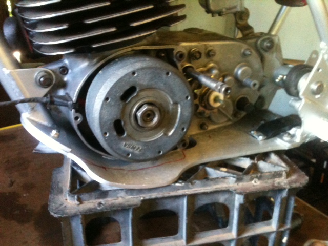

Here is a before picture
And a after photo, Red line is where I'll put a rubber pad
Very nice job. I especially like the rubber slipper for the lower chain run
