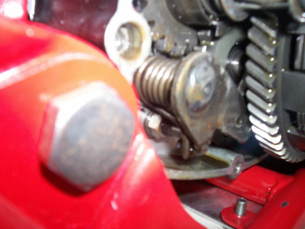

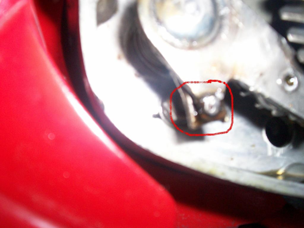

post-18033-0-99223700-1361715031_thumb.jpgpost-18033-0-78742100-1361715090_thumb.jpgHi moocher,
i had exactly the same problem recently. make a small tab from mild steel and weld it on. I welded mine with the selector in place.( Needs a steady hand) make sure you cover the rest of the internals though. think this photo will help. Bit untidy, but theres no way i was gonna get my grinder in there! Don't know why my photos are enormous!?
