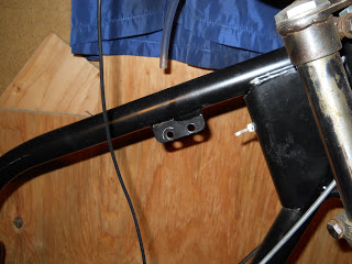

February 24, 201313 yr hi again, You need to grind down to bare metal the mounting point for the coil. Also at least one of your engine mounting points. If your coil is not earthed properly you won't get a spark! Bet thats your problem.
February 24, 201313 yr Author i have not painted frame yet so i will have a look at cleaning to bare metal hope its something simple

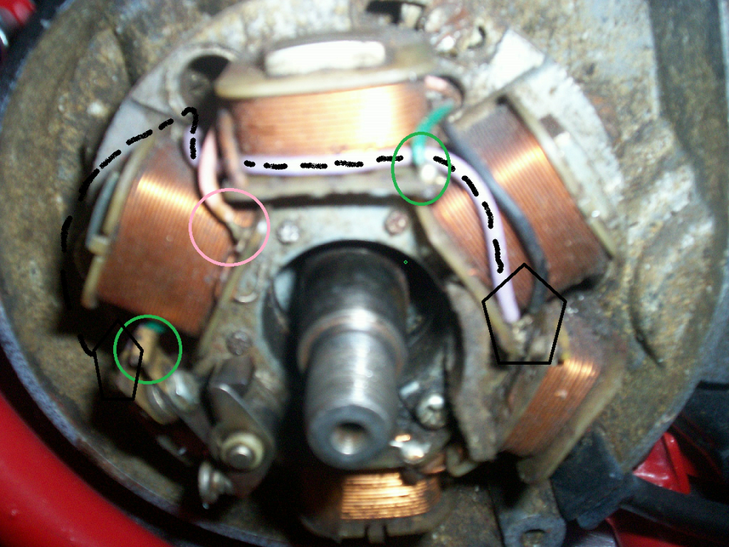

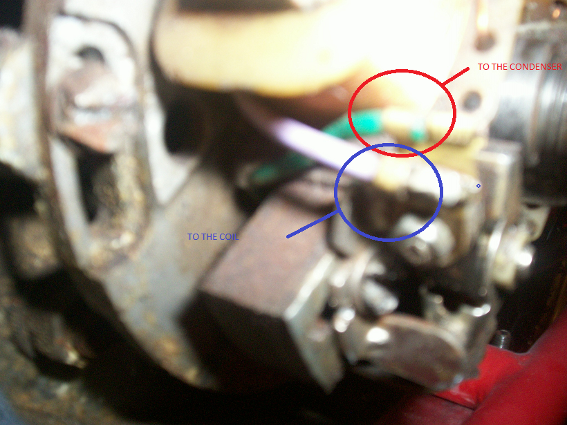

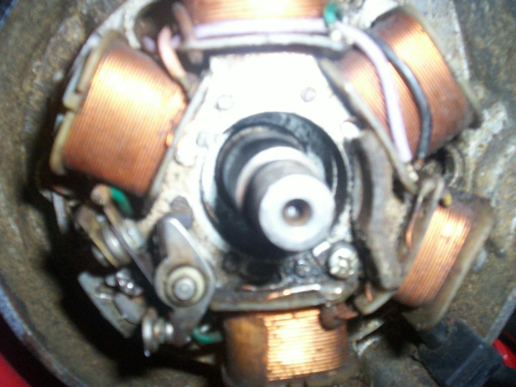

March 4, 201313 yr These photos may help you out mark. the green wire(which is closest to the centre of the stator) goes from the points to the condensor. the pink wire should be black I think as its soldered to the black one that goes to the ht coil
March 4, 201313 yr This one might be a bit easier to understand. From left to right; the black pentagon is a wire connected to the points, if you follow the dotted black line its then soldered to the black wire (other black pentagon) which exits the back of the stator plate then goes on to your coil.the first green circle is from points to condensor. The pink circle is the pink wire which again goes out the back of the stator. the next green circle goes out the back of the stator with the others. Sorry about the bleedin massive photos.
