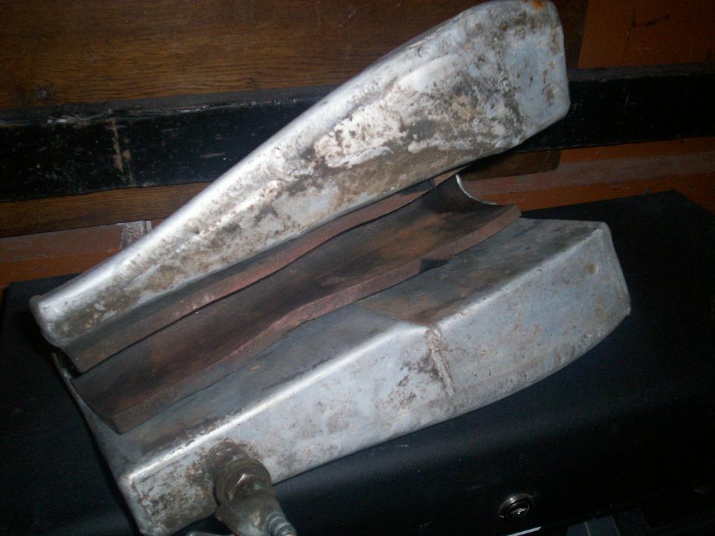

Unless you are fabricating a full tank shroud, there is no need to get into fibre-glass lay up techniques. (however being a grp boat restorer its no big deal!) I've seen the tank shelter you have bought and it will be very easy to deal with. All you need is 120, 220 & 400 grit wet and dry, some flexable sanding blocks, a half decent orbital sander. (NOT grinder) some fibre glass filler and a little common sense. You can get it all from wilkinsons for less than a tenner! (apart from the sander) Have a look at my tank before and after, it was broken off in about 4 places so was my rear mudguard, it had a big hole drilled right through the 'm' logo! Will PM you how i did mine, as i don't want to give all my secrets away Ha Ha. J

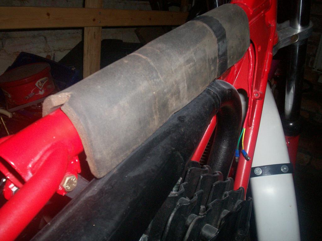

Many thanks for that info fella. Time is something I have plenty of as Im recovering from a knee reconstruction. I havent got an orbital sander but Ive got an oscilating fine detail sander. Im very impressed with your tank. Looks amazing. What sort of mask did you use for all this sanding ? Don't suppose you could include a photo of the tank rubber that sits under the alloy tank. Looks like I may have to make something as the part seems unobtainable.
post-18033-0-74803000-1361919847_thumb.jpgpost-18033-0-70795300-1361919868_thumb.jpgNo worries. Will have a sit down tomorow and mail you exactly how i did mine. As for the tank rubber, here's a couple of pics of mine.Its a bit hard to tell from the photos, but its around 10mm thick, you may have to experiment on your thickness slightly. The basic premise is, it has to be thick enough to trap the tank onto the frame cross member after firmly pressing it down. It should not move at all even if the bike was inverted. The other , equally important aspect, is for it not to push your tank shelter so high that it see-saws on the tank. It needs to be able to rest on the frame at the rear & be bolted on at the front without any undue stress,s from the tank underneath. Phew, that was a bit of a waffle.

many thanks for those photos John. It looks nothing like what i expected it to look like. I thought it may look like the rubber 'U' shape tank holder that was common on the ty yams. Yours looks like a neopreme type material. Looks like my wetsuit may get cut to pieces then !!!
