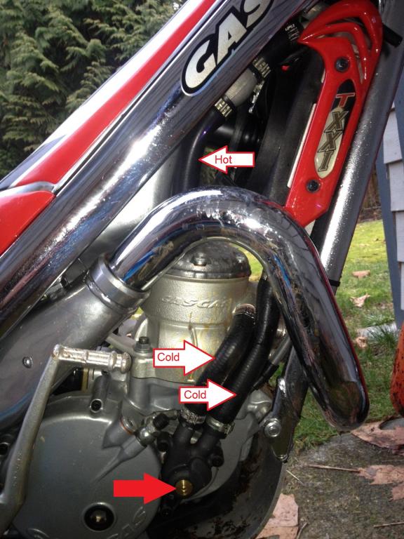

Changed the oil and the coolant as a precaution and took it for a ride.. had the coolant boil over. Steam and liquid coolant shooting out of the vent hose.
pulled over and turned off the motor. The fan was definitely running at this point!
The upper rad hose was hot, the lower rad hoses were cool.
To change the coolant I unscrewed the brass drain plug at the bottom .. not much coolant came out, probably 250-300 ml.. topped it up with 50/50 dexron mix. Put the plug in, hand snugged it, made sure the rubber washer was in place.

No idea if this could be "THE" catastrophic cause, but when you removed the brass plug, you surely didnt lose that tiny shim in there, that goes on the shaft... sounds to me like you have a problem, 1st thing to check probably is that the waterpump can and will function properly, and all that, you will need to drain again, lay bike on its side, remove the pump from case and hoses..might have to flush with air and water if you lost that little shim, it could be caught somewhere in the cooling jacket, or could lodge I guess and ruin the impeller on the pump, it is only plastic. disassemble the pump and inspect. You will ruin the seal most likely, so order a W-P seal kit, it comes with new hard shaft, impeller and seal, and you might need to get that little shim seperately... before doing too much, goto youtube hunt for user "gasgasinfo," find the water-pump movie.

FWIW there is a thermostat on that top hose, (where you said it is hot) just above that arrow, but unlike cars, it doesn't block any circulation, all it does is house a thermo switch touching the water, that activates the fan when it reaches temps, like 170-180 degrees (F) I think it is.
Something is blocked or the blades on the pump "impeller" are a problem, IMHO. and of course overheated now, you might have O-Ring issues in the head, which is instead of a "Head Gasket" but if you noticed overheat condition, quick enough, maybe not.

I figured there must be a circulation issue, wasn't sure if the thermostat is a valve or just to operate the fan.. Going to take the water pump apart later today and have a look inside.. chances are I probably misplaced the copper washer in the pump when I drained it .. I saw the rubber seal thing and thought that was the one I needed to save.. whoops !
Well, I took the water pump and bottom hoses off.. The pump looks good, the impellers are fine, it spins on the motor.. the lines are not clogged, the rad is not clogged ..
tomorrow I will test running a garden hose in the motor to make sure nothing is clogged in there
I was told that it could have been an air bubble causing the pump to cavitate ... i'll refill it and massage the hoses to make sure there's no bubbles etc... other than that I'm at wits end !! hope it works !

I filled it up, ran it for a while and same thing .. bottom 2 hoses were not getting warm at all, even after the fan kicked in and the top hose was hot.
