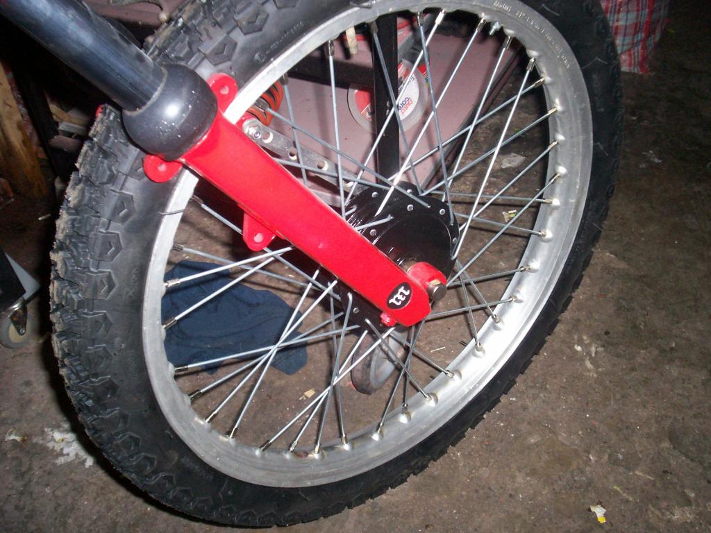

If you have the front hub as used on most 247s and all 348s, then yes the front spokes made for TY175/250 front wheel will fit. Would you like a photo showing my 348 front wheel recently respoked with genuine TY spokes?
Hi and welcome, bombardier. If your 247 front wheel is the same as the 200 cota, i have the exact measurements here for you. Could you post a picture of your wheel & hub. I've recently relaced my wheels and can recomend a good supplier who makes them to order. John
