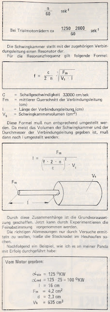

Boost bottle !!!,
E P I C, :popcorn:
very interesting and contemporary indeed. :icon_salut:
How did you measure / calculate the bottle, do you have used the Information given from Trialsport in the beginning 80's:
or do you have used any other ressource?
Have you any practical advice to tell !
Looking forward for any news on that.
:beer:

a boost bottle is a simple chamber that is connected to the intake port of the engine.
So called because the chamber was often a small plastic "bottle" shaped item. The "bottle" was connected to the void between the carb and the reed valve.
The idea was that atomised fuel/air mixture was drawn up into this chamber when the rider shuts off the throttle. The inertia of the intake charge fills the bottle and is released when the rider opens up again.
Often found on 1980's Yamaha's as i believe they had a patent on the idea. See this diagram for clarity.. http://www.google.co...9QEwAw&dur=2698
2-stroke engine design has changed significantly since then.. Powervalves (not on trials bikes), improved carbs, reed valves, ignition, porting has rendered this design less necessary.

TYjay, the RD350 inlet rubber is all that you change, the reed cage will not fit. The advantage as mentioned is that it centralisers the inlet hole to the hole in the reed cage. It also then has a connection point to connect a boost bottle ( dont go there yet ) You will have to shave off a couple of bits of rubber to make it sit flat. If you can get hold of a new reed cage then that would be a bonus, they do come up on ebay from time to time and more so in the states. There are a few guys that sell new replica RD rubbers on ebay but they are sold in pairs for about £30, just get a mate to but one and share the cost :)
