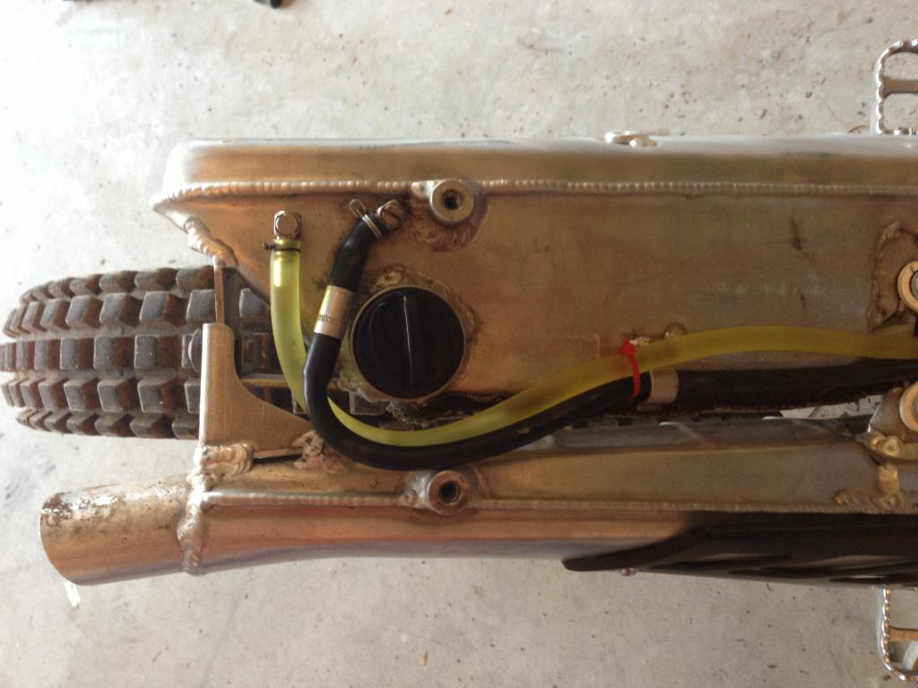

In case anyone else has this problem, we have it fixed. Local rider and I both had the issue, we both did the same mod and both our bikes are running great now.
We basically added the 2013 fuel bypass line. The fuel now goes to a T piece after the pump. One branch goes to the carb and the other goes up to the top of the fuel tank and can dump the fuel back in there. This way the fuel pump is not pushing too much fuel Into the carb. When the float closes the fuel line, it now runs back up into the tank.
Bike runs better generally and no more stalling on downhills.
Hope that can help someone.
Good to know! Do be sure to pass on the feedback to Splatshop Chris as well, as he may have others inquire.
Did you get any pics or part numbers of the new installation?
I already emailed Chris at Splatshot and let him know. I will post a pic when I next have the plastic off.
Here is the new fuel line (yellow one).

I'm having the same problem with my 2013 250 so I'll give this mod a go, did you just drill and tap the tank to fit the extra nipple or did you get a pad welded on first for extra thickness ?
  • 2 weeks later...
I just drilled and tapped. Worked well. had to be careful with the filings in the tank after but I cleaned it out really well. Generally, bike runs much better now. Glad I did it.
