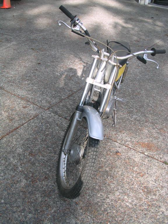

My TY250 is a twin shock so may be different. I found that I had to rebend the lever because it did not have enough travel before hitting the throttle tube. Probably because of cable stretch or bracket flex, but bending the tip away allowed more travel and improved braking.
You can see it in the attached pic. No, that was not from a fall, it is an intentional bend.
