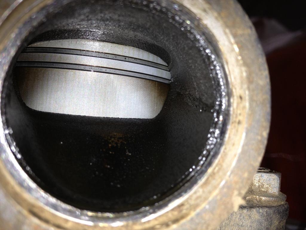

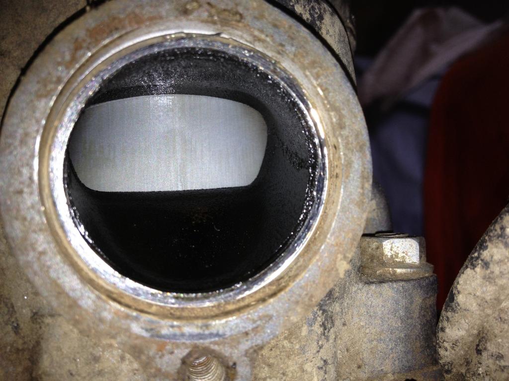

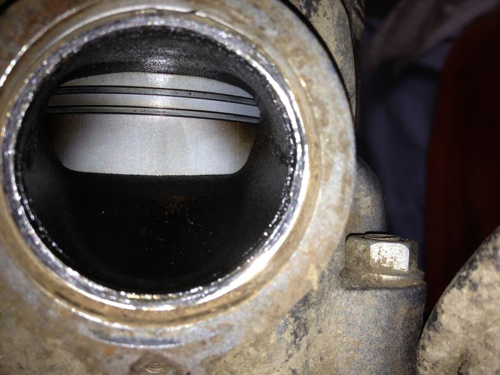

Just wondering if anyone can tell me if this looks like scoring on the piston or if it's just the oil dragging across the surface? Throttle got stuck wide open the other day. Kill switch wouldn't work so a friend put his hand over the exhaust to stall it.
It seemed to run fine after this but after another 4 sections went back to the van, tried to start it again but it wouldn't go. Also some comments made about it looking a bit smokey. Spoke to my local shop would said get the exhaust off and have a look turning the engine over slowly.

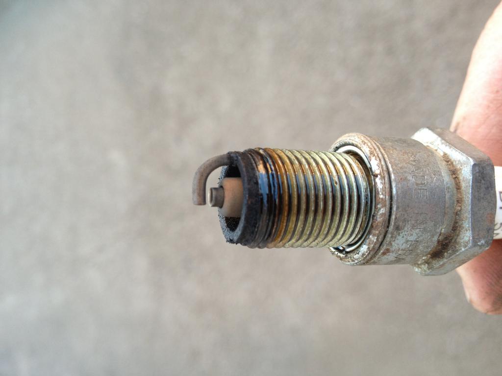

I've changed the plug as a matter of course. The old one looked like this.
Haven't carried out maintenance before (or trials!!!!) so not sure if this is good or bad condition!
The piston looks fine, As he said does the thing spark. Leave the plug out, but in the cap. Ground it to the motor and kick to see spark. Always be careful not to start it on fire!
piston looks fine to me too

Nowt wrong with your piston mate. Silly question but is kill switch stick in? For what it costs if put another plug in to start
Sometimes after a stuck throttle overrev the woodruff key on the flywheel will shear. You will have spark, just at the incorrect time so it will not restart.

Metal transfer is very obvious and I cannot see any on your skirt
I think your top end is fine

Piston looks fine, rings maybe not going off the evidence of blowby below the bottom rings at the sides.
Sometimes the rings lose their tension after a major hot moment such as a bike lying on its side revving until it starves of fuel, can remember NZ's top rider's 315 being like that when he first started riding due that happening lots in his first season

I can tell this is not a new bike, as the bolts for the pipe are verticle. Piston looks good and bike did not sieze, reports compression on kicker feels normal. No report of excess rattle after.
Exhaust port is clean as well, no excess carbon build, so me thinks this a gently ridden bike on pure synthetic oil. A bit of ring blow is to be expected, tarnishing the sides of piston, no excess on yours.
I would be checking the ignition for a good spark and then the timing.Piston looks fine,good job it didn't seize up,would have been a lot of money
