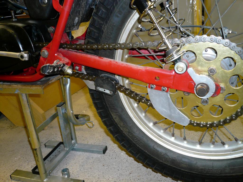

The 200 I had back when it was new had the chain tubes , I cant remember if it had a chain tensioner. But this one seems to have a tensioner from a bracket welded to the swing arm which would get in the way of fitting chain tubes also there is an alloy dagger fin which again is on a bracket on the swing arm to help protect the chain and sprocket from contact with rocks, Would this be correct or has someone fitted a different swing arm ?? the welding on the two brackets looks to be factory and not a bodge.

he means under front sprocket but they suffer from poor tension been so far from rear sprocket ,chain can derail easily this causes bolt to bend and cracks the casing so you are better off with one on the swing arm ,they did not have a rear sprocket guard but again this could be usefull ,, is the swing arm steel or alloy ? a pic of swing arm and tensioner would be handy

As for the other issues I take on board what you say regarding the chain jumping off but would like to return if possible back to original, I didnt have the problem on my other 200 when riding it many years ago so may take the risk and as you can see there isnt a chain guard of any sort so I would have to make one to fit which might not look the part, what do you think?
Hopefully there will be a picture of the swing arm and the bits I'm asking about.post-2260-0-16475900-1368353454_thumb.jpg
The swing arm is steel , and I cant see any obviouse place for the original chain tensioner , no long bolt or holes in the frame or engine plates , could you be a bit more specific with the position of it??

the tensioner mounts to a longer crankcase bolt just under front sprocket ( this was possibly optional on the early 200,s ) it is possible it has been done away with or never had ,the tensioner fitted looks spot on ,personally i would just fit the top tube to keep chain clean and look more origanal but it depends what you want to use it for origanal would be ok for light off road and road use other wise its looking good for real off road use
Thanks everyone for your advice, I'll probably leave things as they are for now and possibly fit the top chain tube as suggested by zerorev3rev4 as I will be using the mont later in the year in local trials. The trials here seem to be lots of rocks and long sections with very little mud as I was used to with the Bath Club.
So perhaps the mods will be better for this type of terrain.

Actually the bike looks great. You`ve had the 520 conversion, as the bike had a 428 originally. The chain tubes would make it look more original, but it was quite a clutter of things with the mount coming off the rear axle. Nice handling bikes, have fun!
