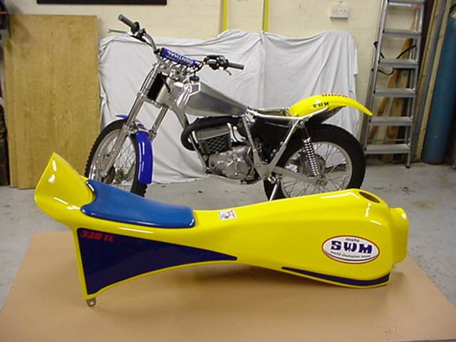

That swm looks to good to ride,Is it going into a collection or into the mud?
That SWM gets a good thrashing don't worry, pity i don't have the time to ride it more often these days :lol:
Yes the old man's responsible for this one, used the original SWM tank as a starting point to make a fibreglass mould from.
Then bent/cut/welded/swore at sheet alloy to fabricate the tank.
Best thing about fibreglass tank covers is no painting required, those blue side panels are just sticky vinyl from the local sign bloke, when your boots wear them you just peel 'em off and stick new ones on. And if you scratch the cover, it's the same colour throughout so still looks good!

Very tidy bike there T/S, fair play mate, you know how to make a bike look good :lol:
Wonder what made you opt for a separate alloy tank rather than making the whole thing out of fibreglass>
Easier to make a tank out of alloy, you can cut and weld and go back and modify if you get it wrong, also stronger and no leaks.
Let's put it another way:
it's easy to make a one off tank from alloy because you don't have to go to the hassle of making two moulds and trying to join them together to hold fuel without leaking and trying to mount it accurately on the frame and getting a petrol tap and cap to fit and stinking of resin for days.
The tank itself is a very simple design which is hidden and i only wanted to make once, can be easily modified and/or repaired and is much stronger and safer the fibreglass.
Bit of a no brainer to me......
