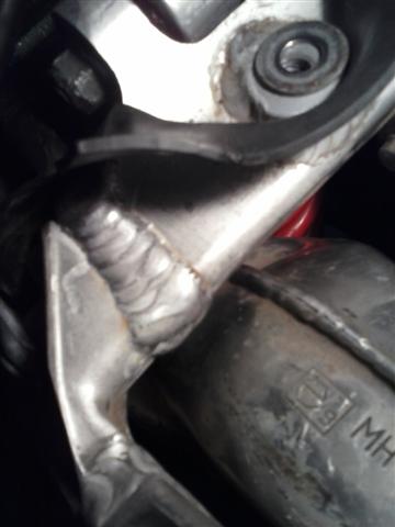

Will post a pic of the fix. Just hope the electrics will be fine

Here is the fix. The guy did a triple layer weld and it seems good. Removing the rear shock revealed bearings that hadn't seen grease in a while. Only slight play vertically, will have to replace in the future. Waiting for my trans oil elf 740 to arrive before starting but electrics seem good as when kicked over the plug is gives a good spark.
