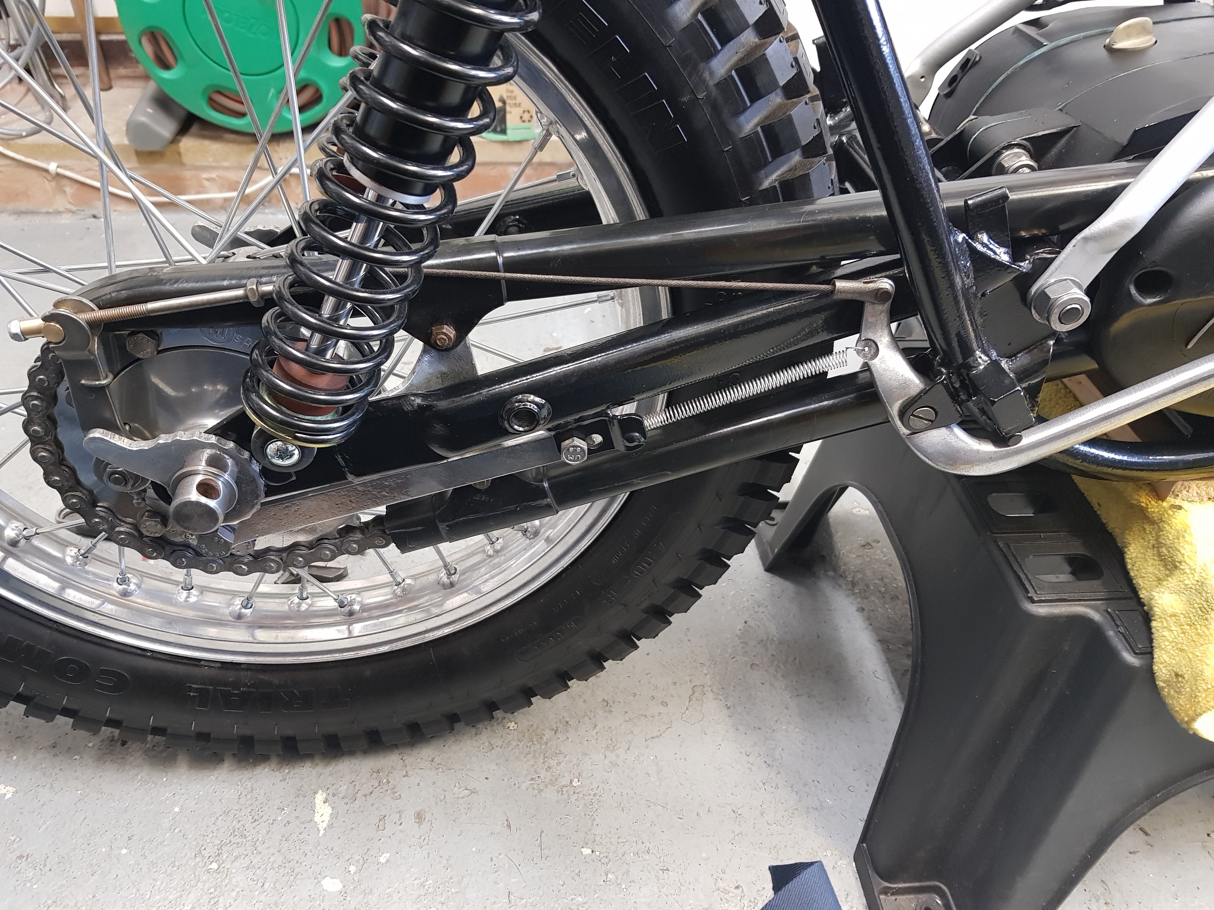

Just re-fitting mine and have no idea if anything goes at the gearbox sprocket end of the tubes, there are little arms with a couple of holes in !!
