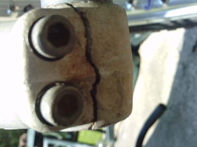

I have a 1999 Montesa 315r and I've cracked the front fork case but can't seem to find a replacement anywhere, does anyone have any ideas of where I can get one from? I've been told they don't make them anymore and the newer Showa ones don't fit.
Cheers
I agree with guys post, had a Fantic and Beta repaired, get the welder to file a groove in the crack then fill with weld. The Fantic has lasted over 10 years.
Cheers, I think that's the best idea, I've got someone that's going to have a look at for me know. I found some forks in the end from a website - www.allensusedtrialsspares.co.uk/#
wanted £200 for a pair... not a bad deal I suppose

695 views of this topic tells me I'm not alone with this problem. The manual says to torque bolts to 7 lbs/ft. Never had a problem with that, just rocks that seem to jump right out of the hill side and attack my 99 315R.
My break looks like yours so was wondering if the weld worked or if you wished you would have done something different.
It seems like the bolts are still doing the job of pinching the axel and the axel is secure even with the complete break.
Any one riding there 315R with this condition? If so, at what level a rider are you, and how long have you been riding with the broken part? Any and all ideas are welcome.

Don't ride with a damage like that, you're gonna make it worse, maybe damage other parts of the fork, wheel, brake disc or something else...
Good advise guys, I hope to hear from others who have welded part and how it's holding up. Thanks
