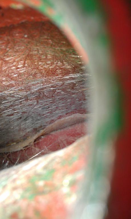

OK - like Italy, we (Australia) got 348s with fibreglass tanks so are very familiar with them. The steel insert for the cap is standard in the 348 fibreglass tank. I'm pretty sure you have the same fibreglass tank as what he have here, so if you want to have a look at the fibreglass, take the tank out in the sun with the cap off and let direct sunlight fall on the tank. If the cap tube limits things too much, find a bright light source and put it inside the tank while the tank is somewhere dark.
If it has never been relined or repainted, you should be able to see the light coming through the walls of the tank, and that will show the pattern of the glass within the matrix. For info, here is a photo I took recently of the inside of a 1974 Sherpa T tank, before I relined it. The photo uses just the flash from the phone/camera. I don't have any photos showing the way the light penetrates the walls.
