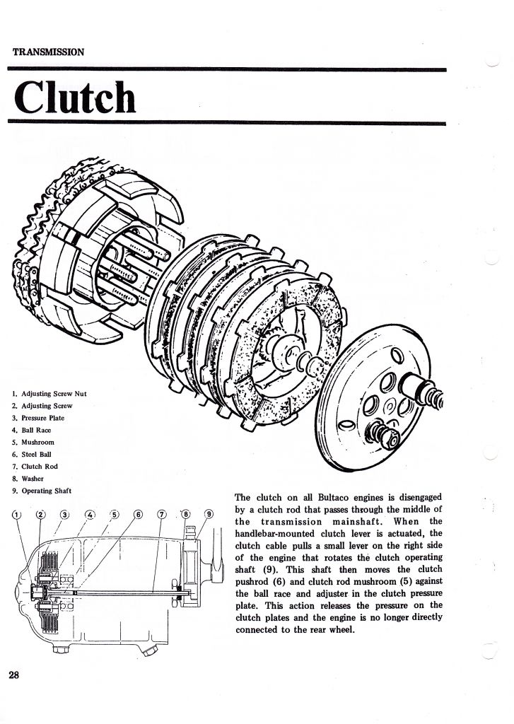

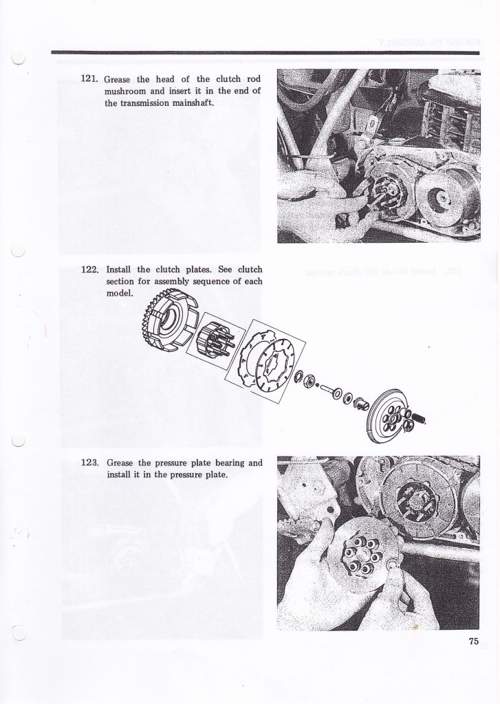

This is the correct way i.m.o.:
About the number of clutch plates: The pressure plate should always just fit over the clutch hub cams so it rotates as one unit.

What you really need is the Bultaco manual.

Guys, I wasn't trying to prove you were wrong, it's just that the Haynes manual says one way and the Clymer says the other, but the proper Bultaco manual would show how they came from the factory.
