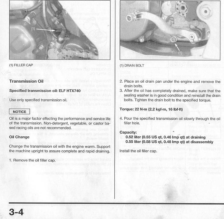

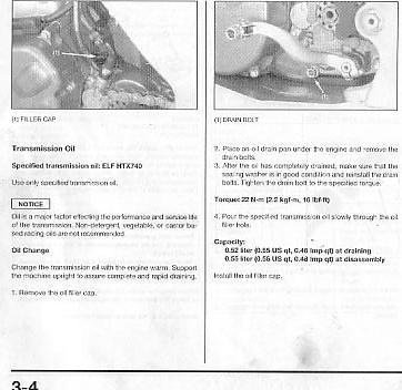

Where do you drain the gearbox oil from we cant find a drain plug? :D

Here is location of oil drain bolt.
this might be a bit better quality, i'm not sure how to add images keeping to the 250k file size.
