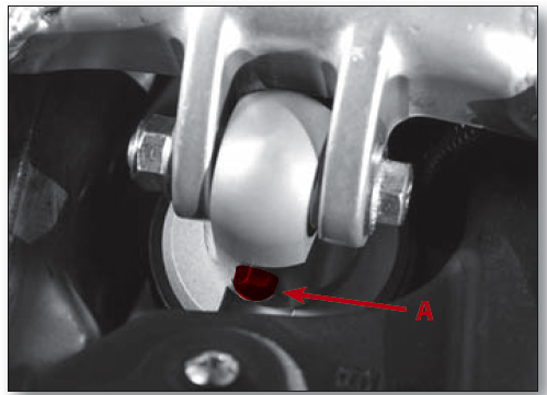

October 23, 201313 yr What is the best way to get a bit more action or response out of the rear shock? 1. Adjust the top screw (see attachment A)? 2. Adjust the spring postion, or add more tension by turning the spacer up? Just looking for a small amount of umph for rear wheel hops. Thanks Tom
October 23, 201313 yr I set my adjuster screw all the way out & have compressed a heavy duty spring a little more. I would still like a bit more bounce so I think the next step is to upgrade the full shocker to an ohlins.
October 24, 201312 yr From the Owners manual. http://www.trialspor...a/documents.htm Page 72 for the 2011 Evo. ADJUSTMENT OF REAR SHOCK ABSORBER Adjustment of spring Ioad •For a more active “quicker” suspension setting, open compression regulation knob A •For a more controlled “slower” suspension setting, close compression regulation A
