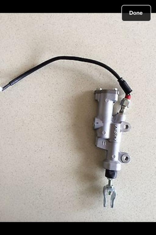

As title says really is there a mod to make the beta brakes work lol as beta must have the ****est brakes dose any one no where the problem lays have been thinking to re place for another master cylinder ? Like this one in photo what's your thorts to it post-17401-0-62683700-1385929567_thumb.jpg

My beta 290 had decent enough brakes so changing master cylinder wont cure your problems I'm guessing, as stated above.

To be fair to the poster the rear brake on a beta is not as sharp as on a gas gas or sherco. This maybe because the pedal is shorter or that the kit is different.
