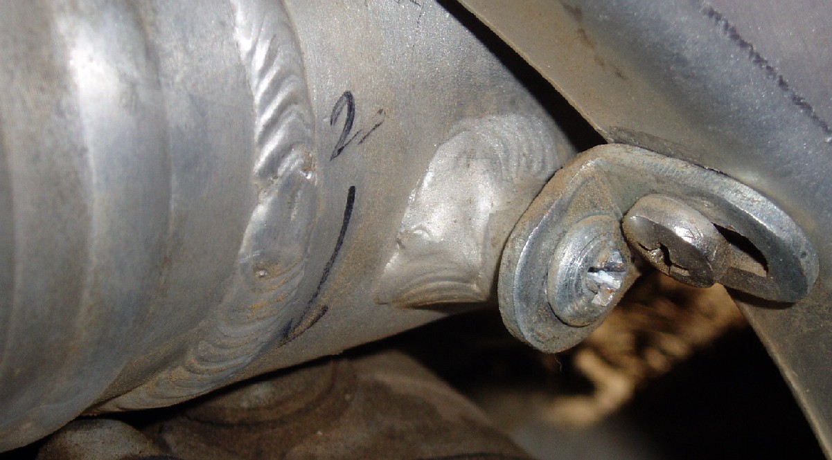

Hi all,
Just wondered if anybody knew a quick fix to stop your muffler from rubbing on the wheel, I am riding an 03 with a Michelin X11 tyre. I have put in quite afew washers on the bracket but this doesn't seem like a very good idea to me, I have recently had the bracket rewelded and this has reduced the problem but not solved it.

I put a double layer of vinyl on the inside but it wore through that pretty quickly, I have had the muffler off and there is actually a crack on the bracket so I have got that welded up so that it points the muffler out slightly, I will also try to get some plaggy washers and see if that will stop it, it isn't too bad though like you say TrialsRFun.

My 05 250 rubbed the tyre on the silencer from new. I discovered after a few rides that the inner muffler was also rubbing on the carburetor. I hated that. I was convinced that the tab on the silencer was welded on crooked and was throwing the rest of the exhaust system out of line, but after comparison with a few other 05 bikes I wasn't so sure. It was suggested that I space it with a rubber washer - I had to use an 8mm thick one to clear the tyre. I didn't like it because it only pushed the inner muffler harder up against the carburettor.
Betas are very well designed, and after discovering that the exhaust parts are machine welded in a jig I changed my thinking - it must just have been the way they were assembled.
Anyway, long story short... The crux of it was the little bracket that attaches the exhaust to the frame near on the left side (which, I think, is only on later models - I'm pretty sure it is not on the 02). I turned it over and clearanced the slots a little. This allowed me to move the inner muffler backwards about 3mm, to the left about 4mm and down about 2mm. It now sits very close to the crankcase (0.5mm), but clears the carburettor. This meant that the bottom end of the silencer mover inwards and the top (noisy end) outwards. I also tweaked the subframe outward a little where the silencer attaches so it lined up neatly with the silencer tag.
This messing about pushed the silencer out and amazingly it clears the tyre perfectly, mud or no mud. No packing needed.

it hasn't just started, it just seemed to have got worse, I took it off as I said and the bracket on the muffler was cracked so I got that re-welded and it is still rubbing a little like before. I will try a decal again and a think washer like you said and see what happens at the next trial. unforturnately I don't think that I have that small bracket RobW but thanks for your help, I don't think that it would go much further left anyway since the muffler was rubbing on the airbox until I glued it to the airbox with silicone to stop any vibration.

Bob, I have seen the cracked subframe on an 02. We did the same thing as you - welded and refitted it without any problems. But I did lever the mount out a little (with a 12" shifter). I think the mount cracked because the rubber mount ("silencer block") was broken and was placing extra strain on the subframe.
Is your silencer block in good condition? If it is cracked or stretched it could be making the difference.

it isn't the subframe which was cracked, just the aluminium thingy on the rearsilencer, as far as I know the metalstick bush on the exhaust is ok, if not I have a couple of spares though. Nothing is broken apart from that tab on the muffler due to vibration as I am told that the type of crack is caused by this.
I could have moved the tab but I am worried about twisting at the joint whenre it joins into the front silencer.
