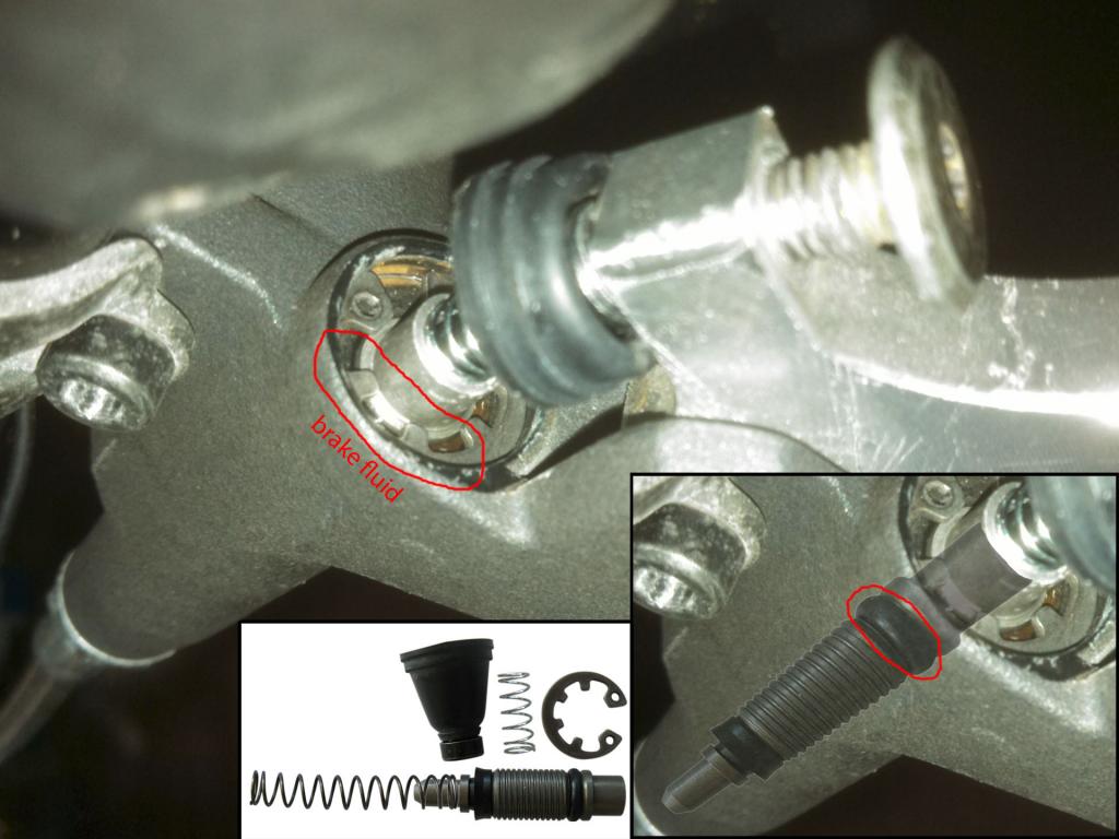

I noticed my front brake became plush, so decided to bleed it, but after some time of process i found that brake fluid is appearing on the exterior of piston (marked at the picture).
I thought it is due to the marked seal has worn out, but decided to bleed to the end... The end was not so lucky so i bought new kit from splatshop and installed it.
But to my disappointment the fluid leak is appeared at the same place and bleeding the brakes is impossible - i pumped lever long time and already have no bubbles out of caliper, but lever is plush and a bit of fluid present at the exterior of piston again. Some time tiny bubbles comes out of 2 little holes in the master cylinder, i assume it is because of that leakage air comes in.

PS. one thought - since seal is not blocking fluid and let air in, maybe put some thin layer of something under it to enlarge seal's radius and it will densely pack an inner tube in MC? Could this solve a problem?
The bore is not scratched, and leakage started even before i start to disassemble and inspect the problem.
Could be that old seal rubbed a bigger bore inside mc and therefore new one can't fill it and leaking?

Make sure the bore is clean and smooth. Might seem pointless but try remove that brown/orange stuff from the rim of the bore and under the circlip, you dont want dirt messing with the oring.
Looking at the pictures above there looks to be alot of gunk!
If a master cylinder still leaks with a new seal kit either the bore is scratched, worn or contaminated/dirty
Edited by guys
I removed that brown dirt just in case, bore looking smooth and clean inside. Maybe i should clean it with a piece of cloth, but i didn't. Didn't seen dirt inside also.

By the way, that seal i have marked on a picture - is it actually seal or dust seal to prevent getting dirt inside?
Which from they two is pushing the liquid and stops it from getting to outside?
And when lever released, first seal (like skirt) is in front of 2 little holes in cylinder with Dot4, or overlaps one of them?
