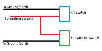

If you want to keep the original kill switch just in case the lanyard fails to work (it's been known) if you wire the switches up as below, then either will cut the engine.
