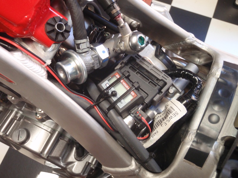

Just fitted an hour meter to my 2014. I'm really guessing the hours I do so I thought why not be accurate and not over or under service the bike.
I fitted the meter on top of the throttle body for a relatively cool spot. Just zip clipped to the rubber hose nearby so no sticking it to throttle body.
That gives easy remove for injector comes out with tank for valve clearance check.

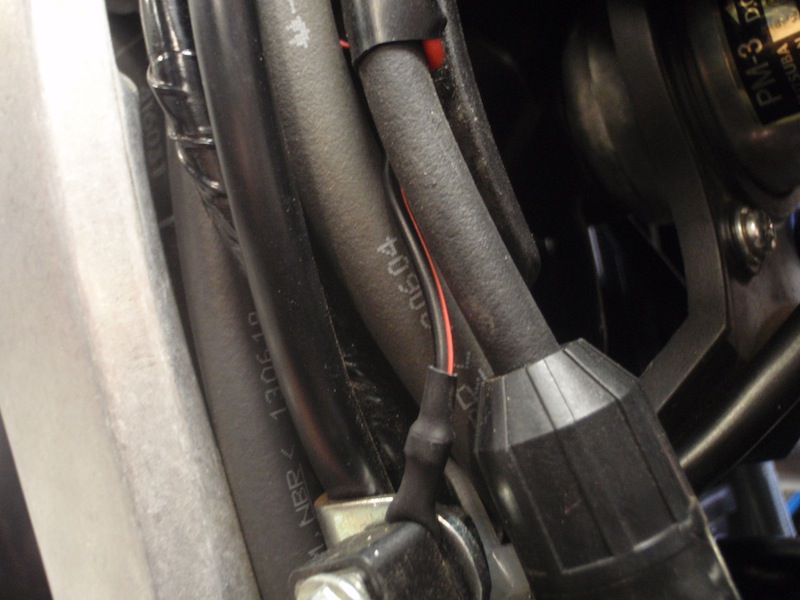

The red wire I just inserted up the HT lead sheath and the black goes to an earth. I placed the black wire terminal under the top coil bolt and the hour meter works perfectly.
All totally removable in a few minutes.
Here is a couple of pics for those wanting to fit one in a hidden spot.

I tried several places for location but it seemed the best as they say not to go above 50 deg C on hour meter (like most electronics) so the ECU area of the throttle body should be a coolish place.
