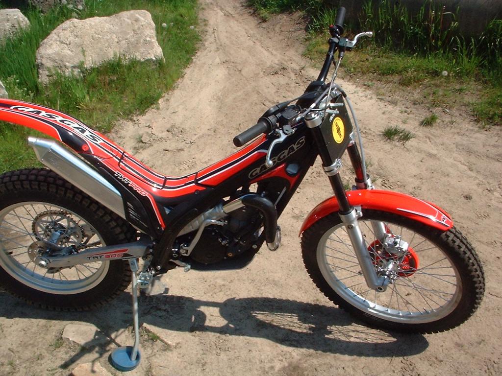

I got a 2008 gg pro 300, with a paioli front fork in it. But according to my knowledge a Marzocchi fork should be in it. I cant find any information on the fork.
On top it says Paioli R&D estension, and on the other one spring preload.
Anyone knows what fork this is?

attached a photo from when it was new
Look at the tripple tree, which is an older type.
My 05 does not even have that, older 2003 did.

I think it was a 2007/2008 overdated bike. (on the 2007 its states on airbox pro 07, this one not)
Edited by crazybond700
Looks like the beta 06 and before triple clamps/tree? Sure I am wrong but I did notice the clamps between the beta 06 and 07.
its an 08 bike , the 07s had black rear mud guard. 08 where red , as for the fork... sherco had paoli at that time i think and so did betas. clamps look like old pro ones like you said on ones like the 03 bikes.
It looks like the beta, but it got original stickers (it was brand new) on the upper side, and there is a special flat space in the fork for the paioli logo...
I dont understand :chairfall:
The bike was brand new in 2008, got it directly from the importer, thats why it is very strange. And i cannot find any picture of the same fork.
Sure it was not an Econo model. Those were the clamps used on the 38mm forks.
Yeah, its different and I think econo model is new frame (tubes)? But its a real 300, and does not have other features different. Also i think the eco uses sachs front and rear suspension.
The forks are 38mm, strange thing the upper clamps are the normal ones.
It was a demo model or so (price was cheap in 2008). Maybe they needed a fork for some client and swapt it. I askes gg usa, maybe a workers strike and some bikes came with different forks. (unfortunatly crapier forks)
I seem to remember there was a stretch where GasGas was having a problem with Marzocci. Political or financial I don't remember but there was an issue that caused a shortage that slowed production. Perhaps you got an oddball proto bike.
I also don't remember ever seeing the logo on the top of the slider on a Beta.
Edited by dan williams
And the logo is not only a sticker but also the metal is shaped behind it.
So the strike might be a logical explanation.
I think I will put my reiger gg 05 forks in this bike
