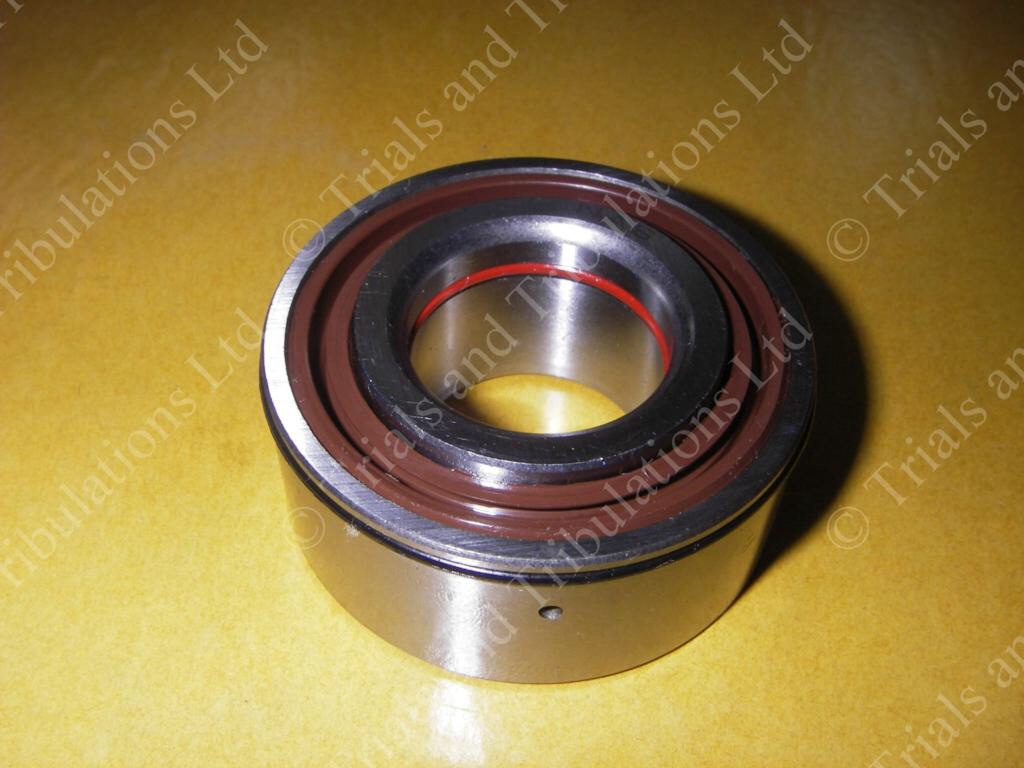

Recently bought myself a 2009 gas gas txt 280 pro, was fine for a while then it started to leak oil from the crank case breather, so I stripped the engine down and replaced the bearings with the new type bearings from gas gas uk which have the inter grated seals and also the small seal for the magneto side
Got a fresh gasket kit and built it back up, started the bike and it's fine for around 15 minutes use then starts spitting oil out of the breather just like it was originally,

Is it this type of bearing with integrated seal (type RS) you mean? This will never seal the crankcase sufficient i.m.o.
