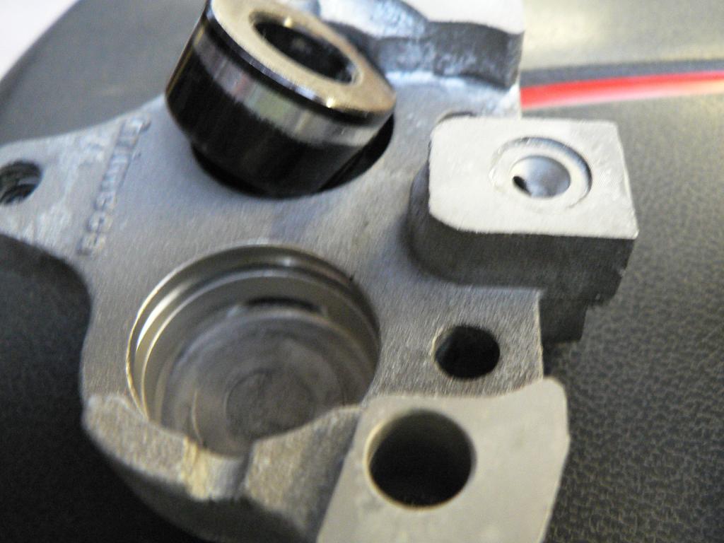

The photo is the Grimeca caliper of the Front of an 2012 Beta on which brake problems started occurring at just over 18 months old.
Brake was grabby and disc was showing more wear than it should.
Caliper was removed from bike and pistons were found to be "seized". They would not move with 10 Bar (150 PSI) air pressure and had to be pumped out with a grease gun.
Pistons should move easily with less than 5 PSI.
When the pistons were out a band of corrosion was present where the black coating had worn or corroded off. The piston in the photo has had the corrosion polished off with solvol autosol.
The calipers were chemically cleaned (as shown on photo) Then the seal grooves scraped out, followed by polishing with fine wire wool, then solvol autosol.
The design of the cylinders is very poor. The fluid enters the cylinders just over 1/2 way up (slots can be seen in photo) meaning air is trapped above the fluid and does not vent to the bleed nipple or back up the hose to the master cylinder. Also the fluid hole drilling that connects the caliper halves is at the bottom of a larger hole meaning once again air is trapped above the fluid.
Hydraulics like central heating systems should be designed so that air collects at bleedable high points. Why Grimeca / Beta do not follow this basic good practice is beyond me.
Also the thin metal cover that has to be fitted between the caliper halves, why not an easily removable (to insect pads / wash out dirt) external plastic cover as used by Honda and Suzuki many years ago.
Come on Beta, you need to do better.
Edit - for those not familiar with this caliper on a Beta, when it is mounted on the bike the part of he caliper at the right of the photo is at the top, so to get a correct view rotate the photo 90 degrees anti clockwise
Edited by dadof2
