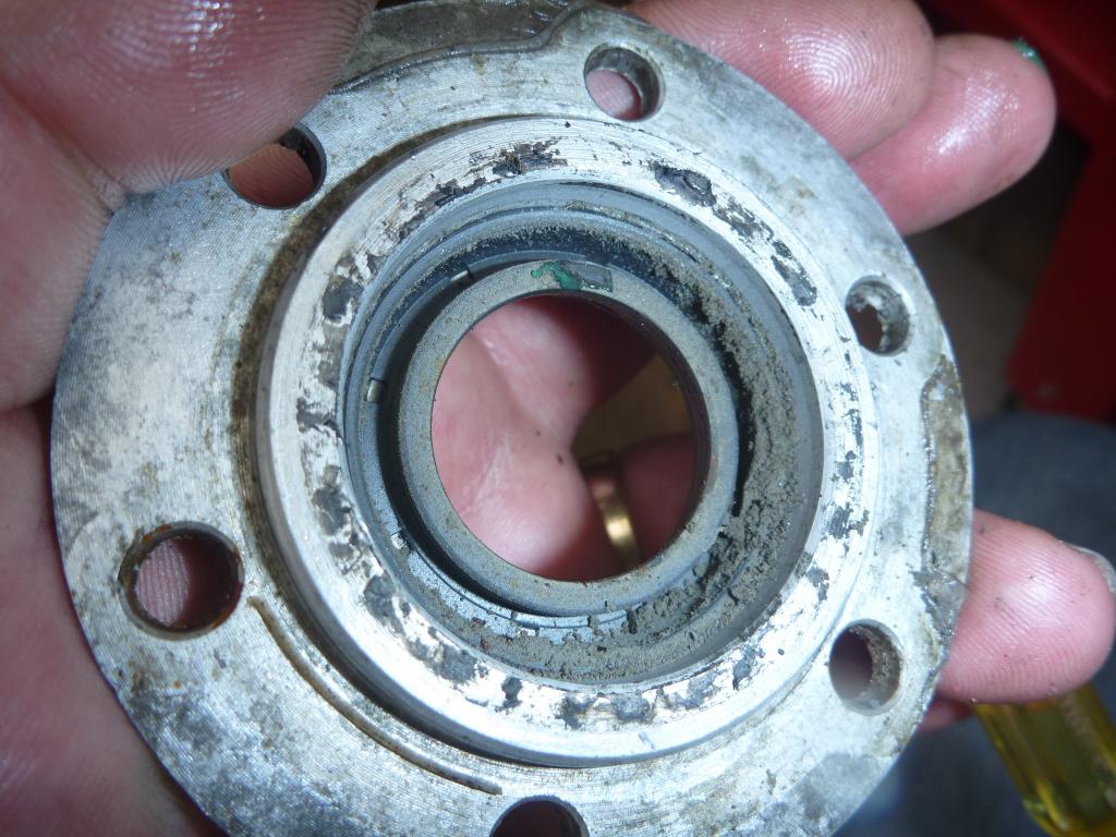

I tried to attach this photo to my last post but it wouldn't go, it's the inside of the crank seals on the clutch side as I found them and wondered if it could have cause the oil to get sucked into the crank case? I know the wear isn't on the shaft part of the seal but it doesn't look very clever!
they look well worn is there a groove on the other side? if so it should have a o ring in it. but with it being a older bike it may have a gasket? it was only the later modals that had the o ring to seal it. be care full when taking old seals out not to damage the alloy carrier. the seals go back in back to back so the open end faces out wards. hope this helps. have fun. oh also on the clutch side there should be a sleeve that goes on the shaft up to the crank bearing that needs to come out as there's a o ring behind it that will need replacing also. but again not 100% sure on the 159 am sure some body will tell you.
Looks to me as though the seal is tipped in the carrier & has been wearing on the bearing. Would certainly allow oil into the crankcase
if there's no up and down and onld abit off side play that's ok. check the main crank bearings by removing both clutch weight and magneto to see if there's any movment in the crank shaft? if not good. there's a o ring and oil seal behind the clutch basket and o ring and oil seal behind the front sprocket. are they ok or do they need changing? the 1 behind the front sprocket is abit tricky to get out but easy just have to take your time. i use i flat ended screwdriver blunt 1 so not to damage anything. once it's half way out use a oil seal puller to pop it out behind that there's a metal top hat also a small o ring on the shaft but if the seal looks ok from the out side id leaft it. you can tell when there worn the metal shows throw the rubber are it leaks.
Thanks Tony, that may well be why it was dry and probably why there was horrible black sludge coming out of the joins and the holes in the exhaust?.........
