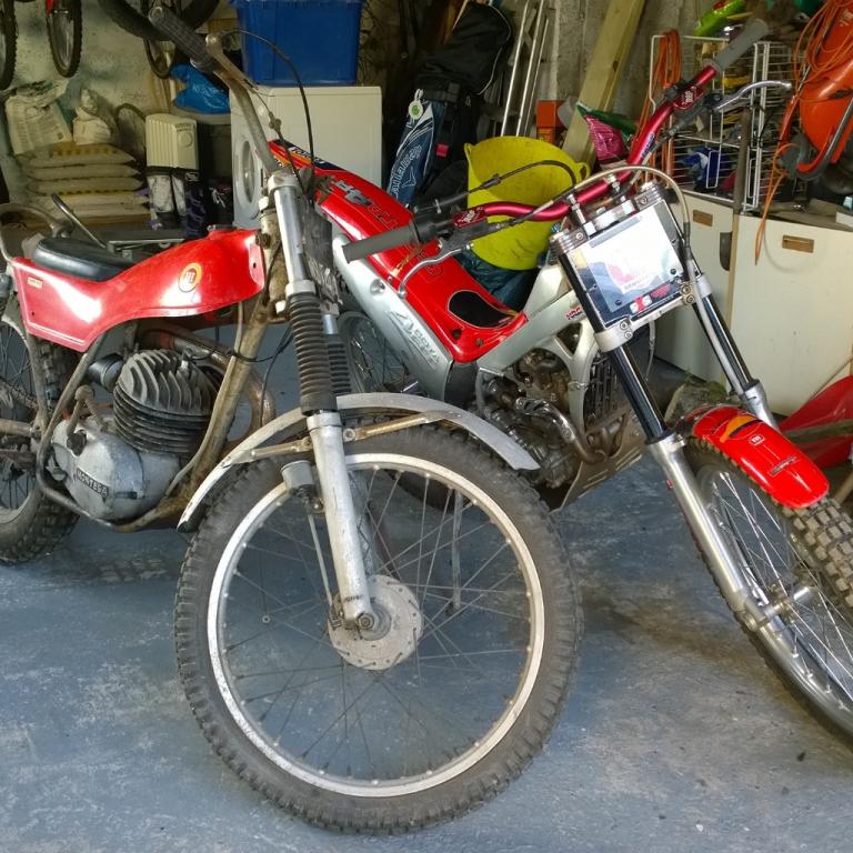

Hi Guys,
I am trying to restore a Montesa Cota 247 which I bought new in 1972 and I have now acquired again. The main stumbling block at the moment seems to be getting a petrol tank for it, I have the glassfibre shell but need the alloy tank. I have tried quite a few places but no luck yet. If anyone has any suggestions I would be most grateful for any leads.post-19984-0-44578400-1408876864_thumb.jpg
Welcome kcc189, I think that you might struggle to find a tank but you never know, thoughts are that may be a yamaha ty80 tank could be made fit and i think the fuel tap is on the correct side as well.

Hi and welcome.
What happened to the tank inner?
They do come up on e-bay sometimes when someone breaks a bike, but they look to be in poor condition.
But could well be repairable of course.
Are you sure about 1972?
The alloy inner tank was introduced in 1973 to meet UK road legislation.
And yours has the still later, right foot brake, left foot gear change.

When I was at the Scottish this year I was talking with a chap who goes under the name of TLR Transformatitons and he uses a plastic tank by Acerbis which is designed to be used under a dummy tank. Might be worth googling or contacting him. The alloy ones were notorious for leaking at the rear seam so better to avoid if you can.
