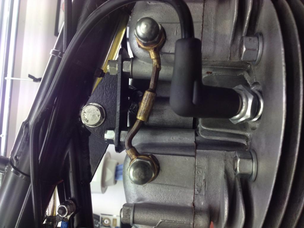

October 5, 201412 yr So, still got the metal on metal noise after the bike has run for around 10 minutes. I sat looking at the engine tonight waiting for a eureka moment and maybe I had one. Have a look at the picture, could it be that as the oil heats up it just flows downhill to the inlet rocker and doesn't bother to flow uphill to the exhaust rocker? The oil starvation from the exhaust rocker then creates the noise.
October 5, 201412 yr looks like the pipe is flattened (starving oil supply) at the bend where it enters the banjo connector stopping the flow Both my BSA B31 and two AJS's the rocker feed starts below the barrel base on the same system (oil return side) as your engine so uphill should not be a problem
October 5, 201412 yr Its longer than I care to remember since I worked on this type of engine but in general the separate flow to each rocker should have a restriction in it so it can't take all the oil coming up the single feed. This forces equal amounts of oil to both rockers (or camshafts) irrespective of oil viscosity or gravity. I know of some car engines where people have failed to replace these restrictors resulting in oil starvation to parts of the valvetrain. Perhaps something similar is your bikes problem
October 5, 201412 yr Not sure what your engine is, but the British singles and twins I owned had pressure fed rocker assemblies, using one feed pipe teed off to feed both rocker shafts (looked like that in your pic). Start it up and loosen one banjo nut, oil should come out, tighten it up and repeat on the other. If good. Look elswhere, eg loose tappet, broken valve spring, snapped rocker shaft, missing or broken rocker shaft sidethrust springs/shims.
October 5, 201412 yr That's a C15 head. I can't see any kinking or flattening of the pipes and I can't imagine the oil not being able to flow up that little rise if it's just managed to get all the way from the bottom of the engine. Have you got a copy of Rupert Ratio? Might give you some ideas. If not then try asking on b50.org forum, some very knowledgable BSA unit single chaps there.

October 7, 201412 yr Author Thanks for the posts. So the latest status is: Oil pipe feed is working fine I was straightened the pipe and checked that oil is still flowing when the noise starts. I have checked the clearence between the stator and the pick ups which if fine. I have noticed though that when the noise starts I start to see air bubbles in the return pipe, any thoughts?
October 7, 201412 yr The return side of the oil pump is bigger than the feed side so it will draw air once the crankcase is flowing properly My cub and BSA do this as they both have clear plastic oil pipes If not the oil is not being supplied to the engine or it is filling up It take a minute or two for the air to appear as the oil will drain to the bottom while the engine was stopped
