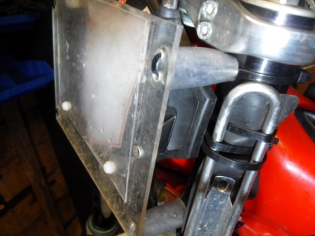

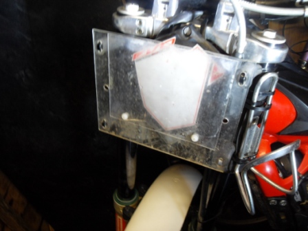

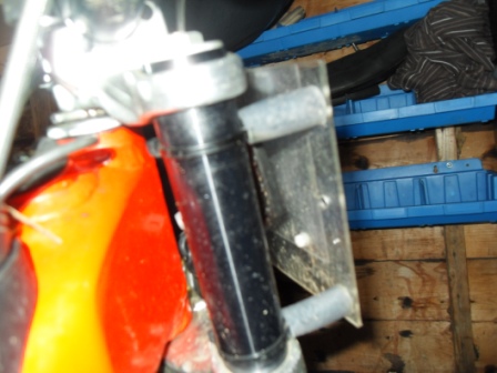

Number Board On An Evo With A Headlight
Here is a way of putting a number board on an Evo, while retaining the headlight. If you use a transparent number board then you can still use the light. You don't need to alter the brake or clutch cables, or anything else.
You will need:
A number board.
Some long cable ties.
4 30mm lengths of soft plastic tubing - 10mm - 20mm bore.
drill + 5mm bit.
(You may need to join short cable ties together to make long ones).
Look at the pictures to see how I did it. I have used this for the last year, with a trial every week and I have not had any issues with it at all.
Also, I have a drinks bottle carrier attached with cable ties, It is sitting on a piece of inner-tube rubber to protect the forks from scratching. Nearly a year, used weekly with no issues.
PS: Don't use a plastic bottle holder, because it will break when you go over logs.

I suppose if you really can't do without the light then this is a way to have a flat number board with no disadvantage.

This may be of interest to Ossa riders too, as some have the battery boost start attached to the light so numbers need to be taped to the headlight.
How about the simple bulldog clip, Been using one for years and have never lost a number even when giving it some on a straight.
Used on 2 gas gas and 1 sherco now.
I'm not knocking your creativeness but I could imagine it slicing someone to pieces in an accident.
If I was machine examining and came across it you would be back to your car for some wire cutters before riding.
I do mean this nicely, Please no offence.
