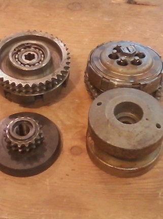

Have 2 mod 92 in the shop today ( square cases, clutch adjuster on RH side)
the wheel below is identical to the mod 85 250 that is on the shelf , at one time I knew the exact difference
in weight but I think it was 8 oz lighter, as a point in fact we put it on our young lads competition bike for
fun & his only comment was "I have lost my traction a bit"
As for the Alp with the broke wheel, probably either would suffice
Went searching & the early M 10 ect 250 cc W/ clutch adjustment on LH side are indeed quite rounded, &
would certainly foul M 92 wheel shoulders.
Larry
Edited by lbhbul

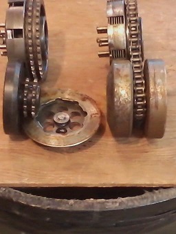

this is the later 199A and 198A clutch weights.
Bondy, First off thanks for the B mod flywheel comparision, I suppose the smaller wheel would certainly help the 250 out.
I wanted to show 2 ways to help the original poster a little bit; don't you all know how quick the Alpina would be with the duplex
wheel, and it would be fine with the 250 wheel also I believe, just say maybe 50 teeth or so for trials possibly.
Larry
Edited by lbhbul
Early 250 Sherpas had the double weight, then they went to the single weight but not sure when, maybe '75.
The 250 198B uses the lighter Pusrang weight on a single row cog, really picks up quickly.
yes the 250 weight is from a 198A sorry not the B
