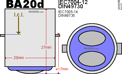

I think you are looking for a 12 volt BA20d bulb. You'll need to study and measure the socket. A BA20d has a 20mm diameter base with two flat bayonet pins (one larger than the other) and two contacts (hi and lo beam).
Check to see if it matches this...

Thanks aussiechris for the reply. That very much looks like what I need. Thanks!
