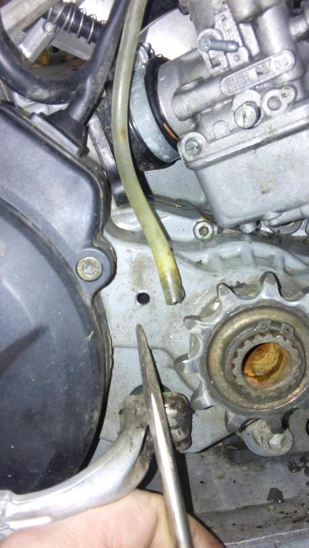

But the problem is that my chain jumped when i was riding in the woods and tangled around the front sprocket and broke off the nipple in front off the sprocket. I´m wondering if my only option is to split the engine case and extract the broken nipple or is there any other solution for this problem.
Best regards Verneri from Finland
Yeah, thats a little bit weak design. You can try flushing it and see if the magneto catches it. Otherwise you need to open it...
Not that much work, but riding is more fun! lol
I´ve been trying to get the broken peace down into the gearbox with sticks, shaking and blowing air with a compressor in the hole with both oil-drain and oil-screw open to get maximum air flow and to not blow any seals, but no it only moves back and forth. How can I get the broken nipple down the gearbox or is it designed so that the broken peace can´t fall down the gear box and destroy anything?

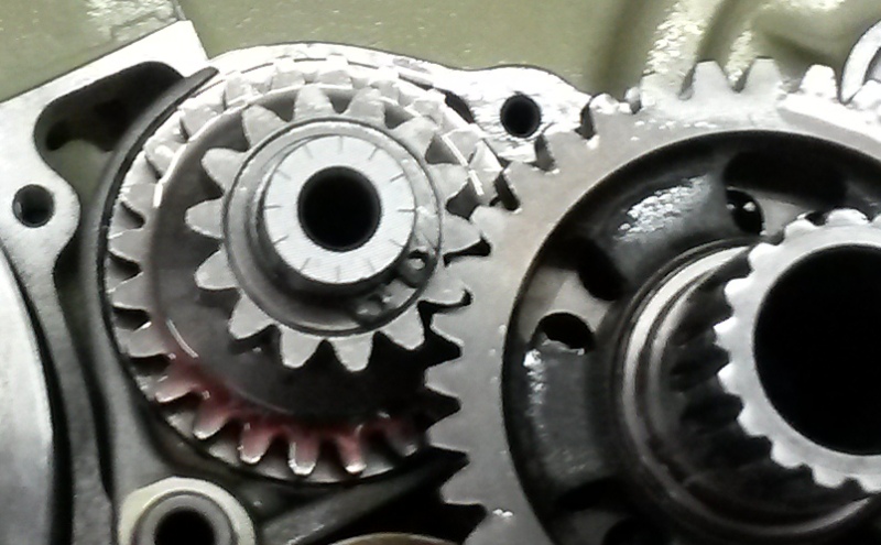

If that broken nipple has gone inside then it should still be contained within the hollow transmission primary shaft. The left hand bearing of that shaft surrounds the breather. The clutch is attached to the right hand end and the clutch retaining screw has a small hole to allow breathing but would be too small to allow that nipple to escape.
You could try the following: Remove the clutch cover, then remove the small allen screw in the centre of the clutch (it's either 4mm or 5mm internal hex but I can't remember). Then you should have access to the nipple inside the hollow shaft. But I still don't know if you will get it out through the screw hole.
Otherwise you can either leave it in there or you'll need to split the engine to remove it from the left side of the primary shaft.
These pics show the left end of the shaft and the bearing it sits in (the hole is where your nipple belongs). Unfortunately, I don't have any good shots of the clutch end.
Chris
Brisbane Australia.
Chris is right yes, offcoarse. The breather is breathing through the clutch bold, and so has fallen inside the shaft.
I think you will need to disassamble to take it out.

No, its inside the left tube on the picture above. The other end of that tube is where your clutch is mounted on.
