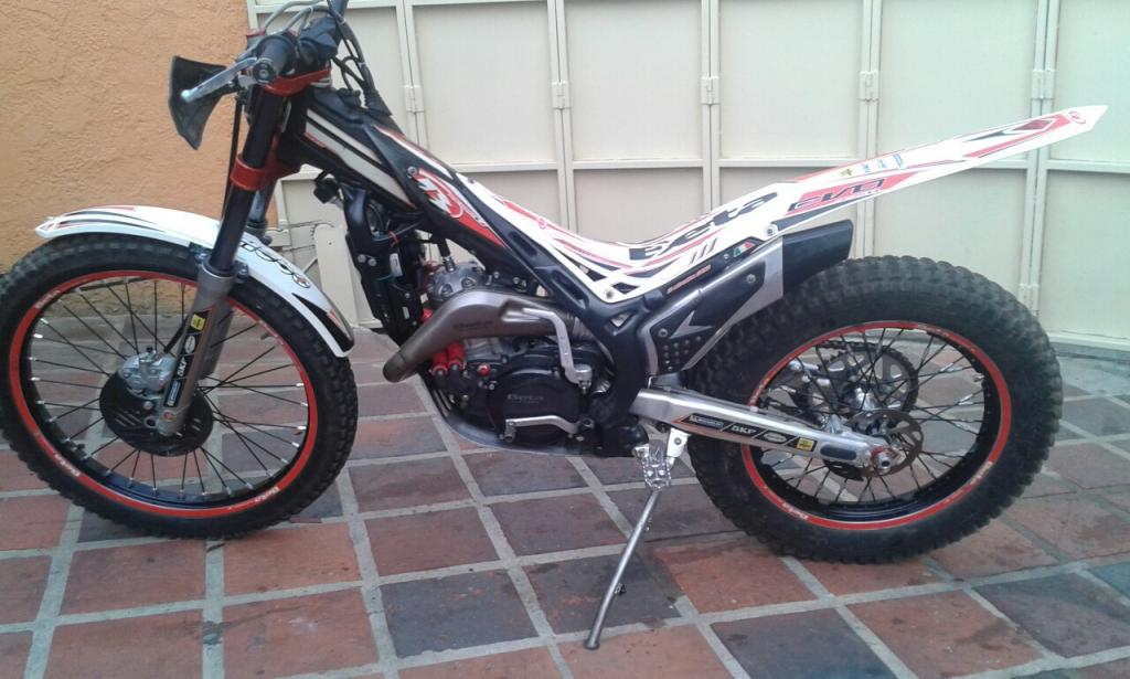

Yesterday sold my rev3 2006 for 3.500$ and bought a almost new 2011 evo factory 300....for only 4.500$ :xmas::banana::bouncy: :bouncy: :bouncy:
This bike was stored for 3 years and used only a handfull of times !!!
I have to thank God to put this bike on my Hands !! Blessed !!!
All I can say this new bike rips !!!
Super Snappy and really Powerfull compared to my rev3 270....
I had to be ULTRA Carefull with the throttle.... this bike is a Animal in Steroids !! jajaja... Really !!
A total different feeling in all senses,..
The Geometry and the Stability is out of this world !!! This thing is Rock solid !!!
Beta really did a great job creating the new evos... they are plain incredible !!!
Ill have to Salute all of us whom own this Evos Bikes.... We are truly BLESSED !!

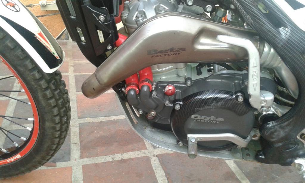

The difference with this factory and the normal evo... I beleive is a bit more RED BLING BLING ....
And a AWESOME AND ULTRA LIGHT TITANIUM Front PIPE !!   The normal EVOS comes with a Stainless steel pipe...

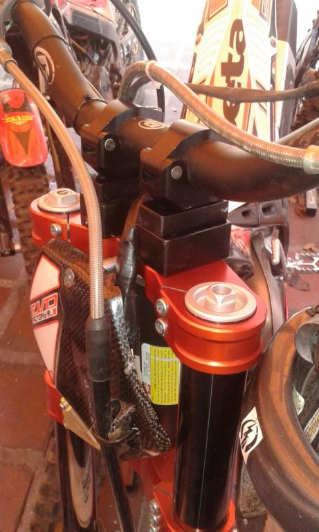

Had to Custom made these Risers in Aluminum and now I feel waaayyy more comfy in my bike cockpit..
A little black spray paint and voilaa,,,went out yesterday and the difference is amazing !!

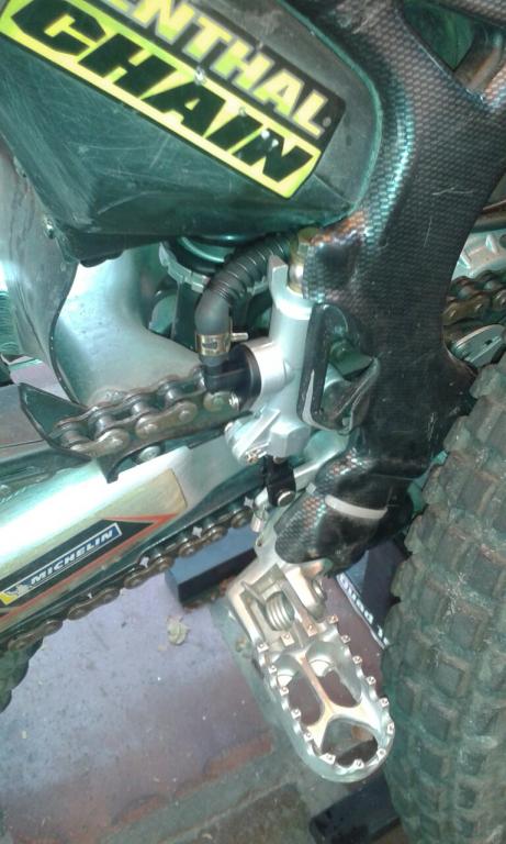

The OEM Rear Master Cylinder is really bad..
Had Problems with it since day 1.
Had bleeded it 4 times.. with all the techniques known and tricks...
And as soon its get hot... I loose all pressure and rear brake pedal fades all the way down...
There are no leaks.. opened the rear caliper , took out the pistons... cleaned them.. lubed them...
and same ooo problem..
Solution :::
Rear CHINESE Master Cylinder Pump...
Now I have a really Precise Rear Brake... No overheating ( This has Lots of more Fluid capacity and a LARGER PISTON ASSEMBLY INSIDE )
Plus a reservoir , which I attached zip tied to the frame...

The risers made me feel better .... Im really Tall  :huh:
God Bless Trials Bikes :hyper::banana: :banana:
As far as risers go tall, has nothing to do with it. Ever hear of short riders raising the foot pegs? Raising the bars considerably causes loss of leverage and loss of forward body position on large ups. But, if you are putting many miles on the trails and not riding trials enjoy.
