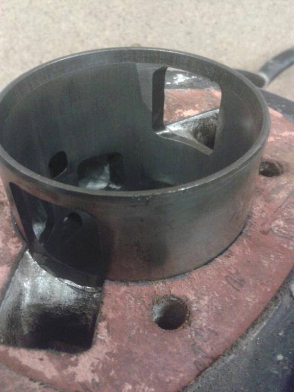

I took a picture of my barrel, the distance is 32.9mm from the gasket base to the edge of the liner.
But you now seem to have it sorted!
Your cylinder is very different than mine. I should have taken a picture before I out it all back together. Yours must extend into the case much more than mine does. I had to cut mine down to about 16mm to get it to fit.
