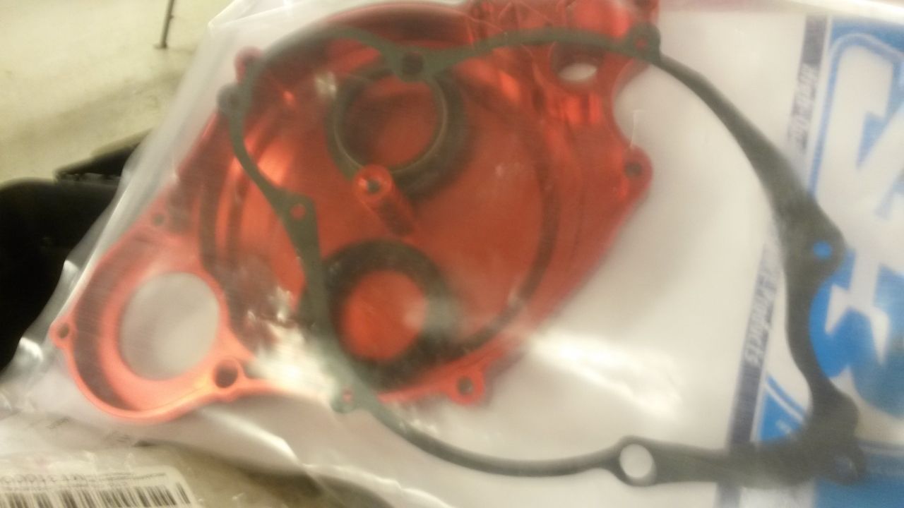

I have replaced a damaged kickstarter cover last friday, and too badly also saturerday whole they.
Took a s3 one and mounted without problems, bled the system, nor worries.
Untill tried to start it the kickstarter did not went smooth enough (did start and worked fine for the rest)
Spend hours dismounting and mounting parts to figure out where the problem was. Without the clutch no problem, with it it was too thight. Without the crankwheel no problem, with it it was again too thight. Searching searching etc.
Finally sunday morning, replaced the kickstarter spring, the cup where the spring is in. Not stuck anymore, but now the kickstarter would not grap (the 1/4 wheel stayed behind the idle gear). Also replaced the other ''spring'' on the 1/4 wheel, and problem solved.
So if you have a problem with this sometime, its worth trying out a new spring and ''spring''!
Strange thing was that I took the old cover off, and did not though the kickstarter system, and put new cover on, and the problems started. Put probably the kickstarter was on the edge of having problems for a while and now it reveiled itself, lol.
