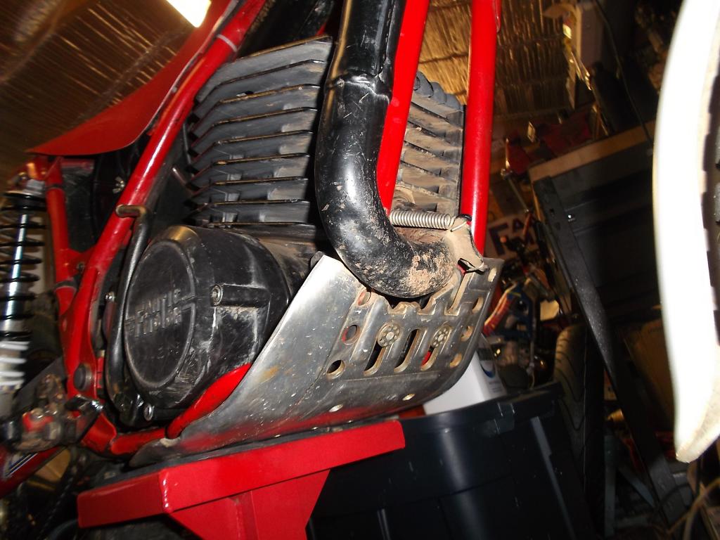

I use a factory fantic aluminum skid plate off a later model ,I don't remember which one , but the profile/bend is correct , and all I did to mount it was drill a few holes and add a notch to clear the exhaust . It's pretty stout too ! :)

post-1232-0-69168500-1432120303_thumb.jpgpost-1232-0-20843300-1432120334_thumb.jpgHere you go , excuse the dirt ... And you can't see it , in these but I added a hole so I can change oil without removing the skidplate. , And those are some trick Flush surface mount bolts , with the allan head hole way up inside . So you can always get them off without fighting damaged bolt heads ...
Glenn
The above plate is too wide for a 200 really, I think Adtek do one and another company from South Wales, mine is a Adtek but it did need modifying
I have an Adtek one on my 240. It needed modifying to fit, and it is also a bit on the thin side.
Is not the 200 pro the same frame ? And I'd rather be a little too wide than to narrow ... And I think I paid 30.00 usd for it , and I have yet to see a aftermarket one that is as thick and any where near the same quality of material ....
 Just Saying :) The fit was worth the effort .
Glenn
Axul - That's off a 301/303 as I have the same on my 240 !!!
I might see if I can fit the same again - but maybe trim it down as the 200 doesn't stick out past the down tubes like the 240 !!!
