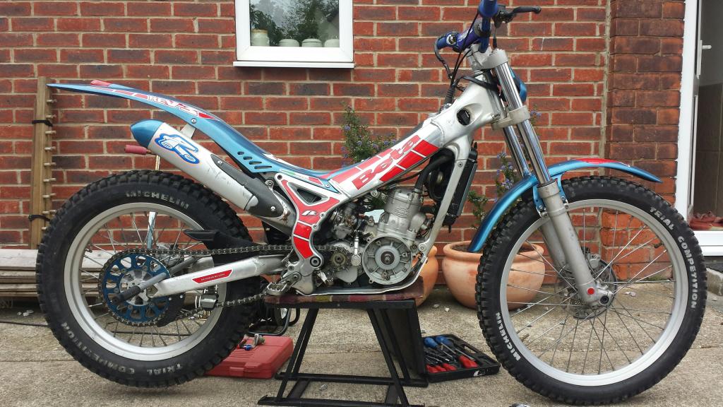

I have attached a pic, anyone able to tell me what year it is.. ignore the decals as I put them on it.

Looks like it had some stator work before. I`m guessing a 2001. The 2002 air filter was under the seat. I cannot remember the stator readings, but I would double check the grounds and kill switch first. Good luck.

Methinks the 2001 had, as mentioned the airbox cover on the left hand side instead of through a flap in the seat.
I also seem to think the switch for the fan was fitted to the top of the radiator on a 2001 and from 2002 onwards, it was fitted to the bottom.

To confirm the year give Lampkins a call 01535 655970 or visit them on the web http://beta-uk.com/and tell them your fame and engine number.
The 2000 and 2001 air filter was accessed from the left hand side behind a cover located that looks like this.
The chain tension block is on upside down.
Eeek! I just noticed the rod through the rear sprocket. Guess I know how he got the flywheel undone. Not great for the crankshaft.
