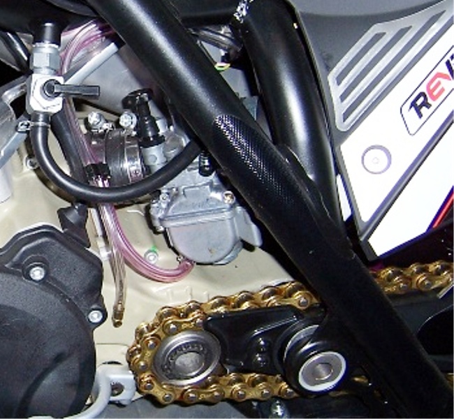

My bike was delivered with the overflow tube routed up hill as in the picture below. I don't don't believe this is a mistake as it even has a little factory made clip to hold the overflow tube to the transmission breather tube.
Anyway, I have left it like this for the past three years and it works perfectly. It seems like it would be no better than blocking the overflow and yes, it has fuel sitting in the tube all the time. But the bike runs perfect in all positions, doesn't spill fuel unless I crash, and uses less fuel than any other bike.
You may not like this set-up but it would cost exactly zero to try it.
This was taken on day of delivery in 2011...
